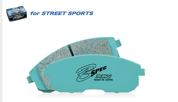

    Or you can go all out.
    http://www.project-mu.com.au/en/products/pad_bspec.php

  • #7
    Quote Originally Posted by ThatsHowWeRoll View Post
    Really! devastated...they are really good.
    I saw the link>>
    but then...
    v_v being broke sucks.
