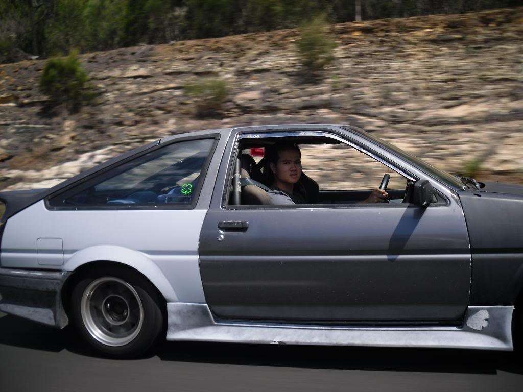

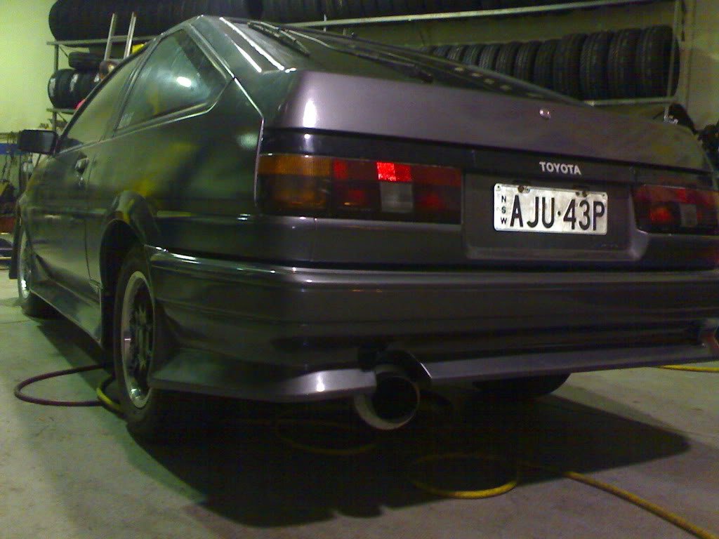

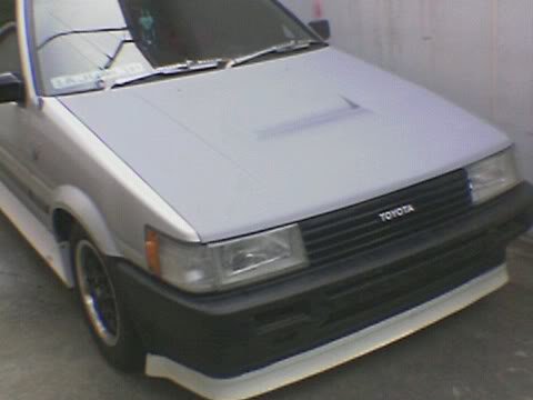

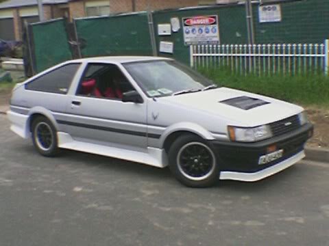

from her birth to her present

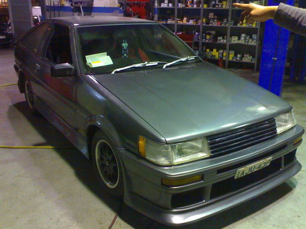

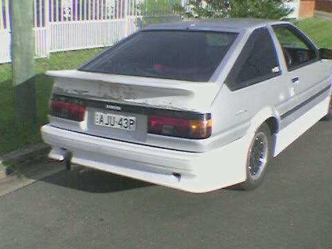

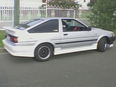

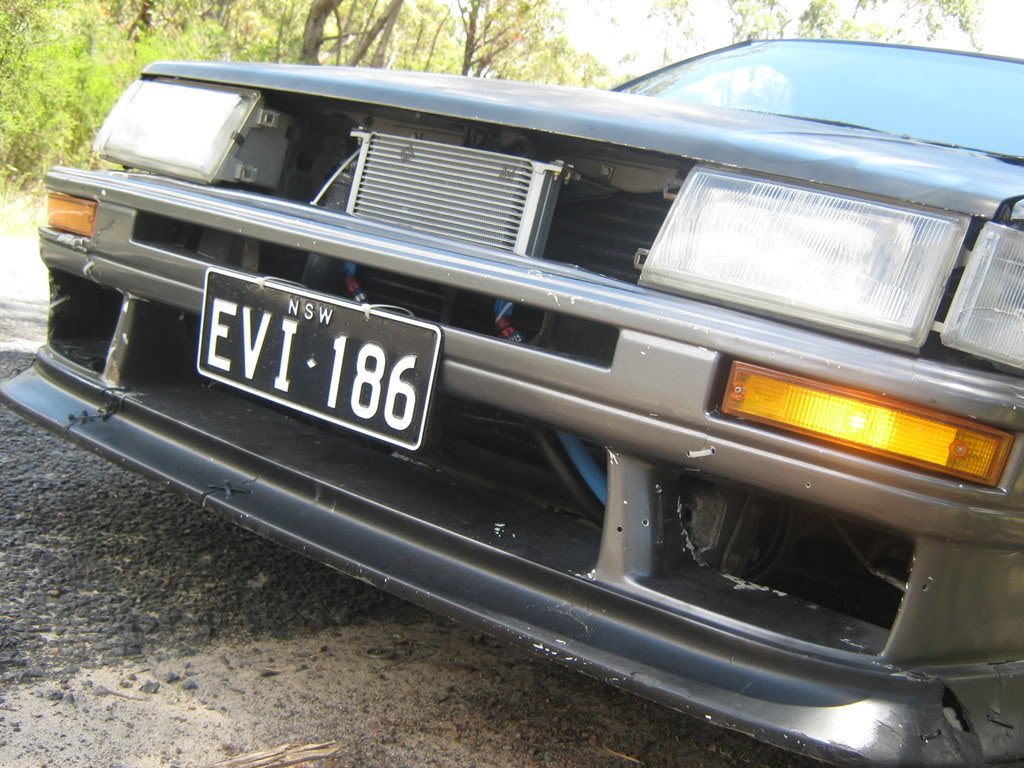

After i first got her

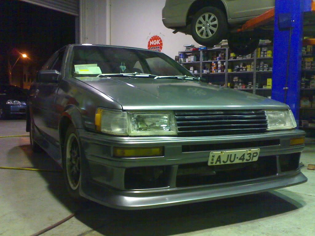

before rego

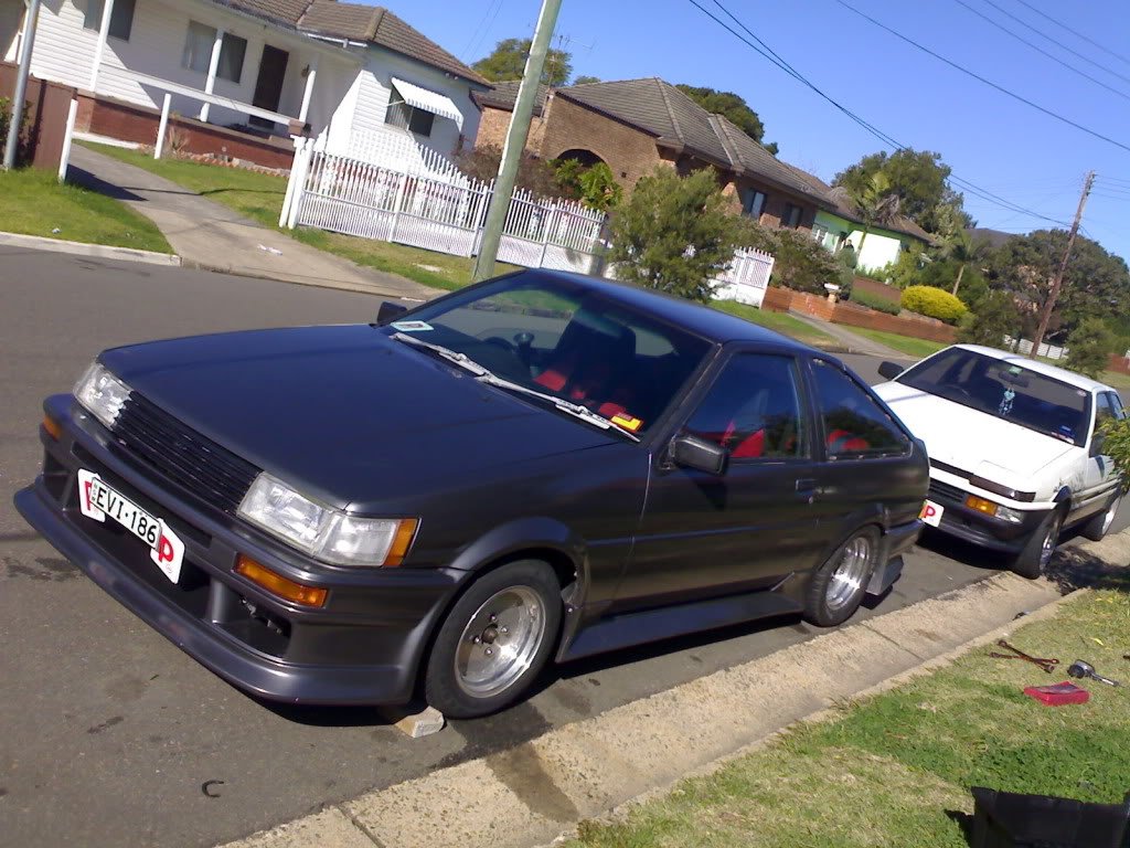

after rego

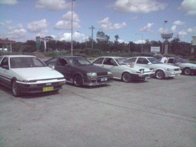

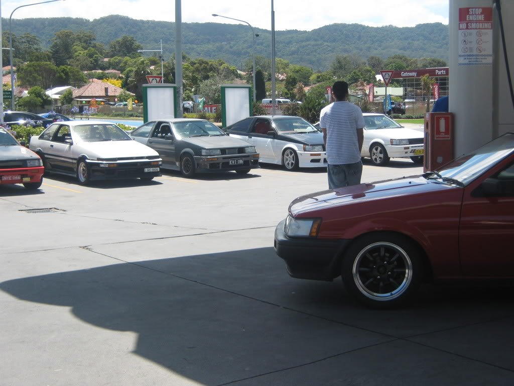

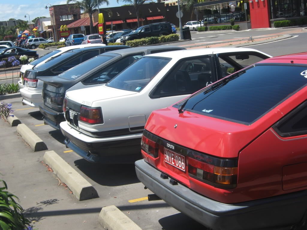

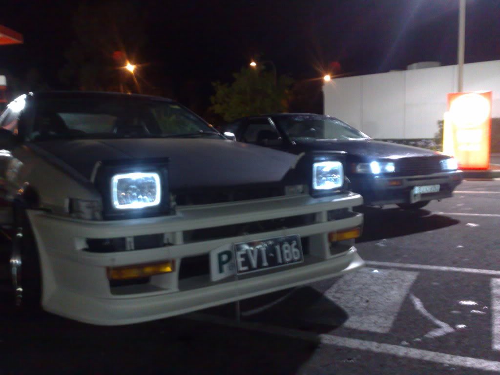

Monthly meet awhile back
JDMST mini siliverwater meet

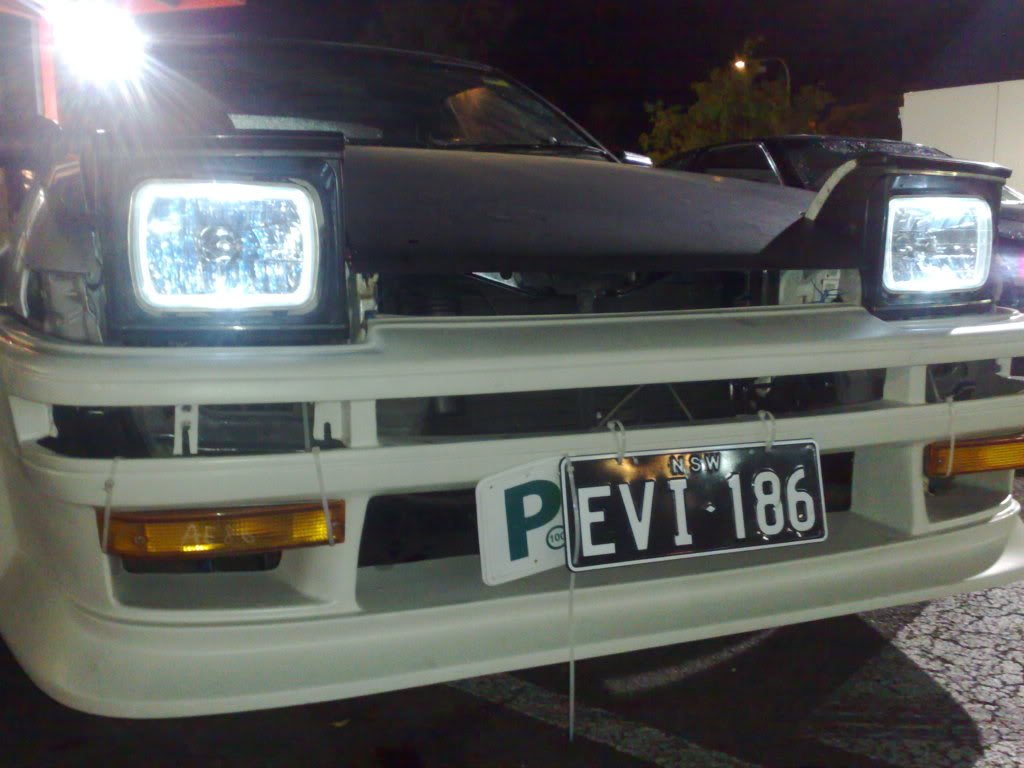

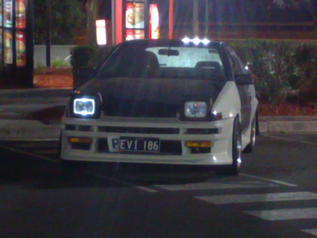

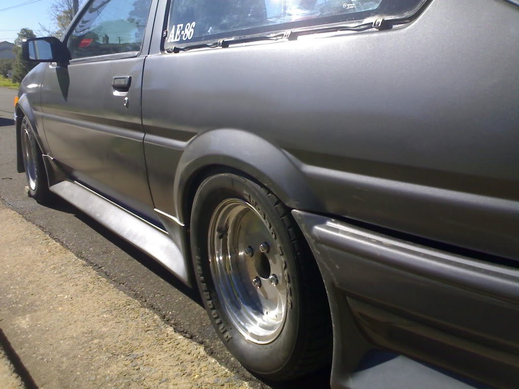

Now

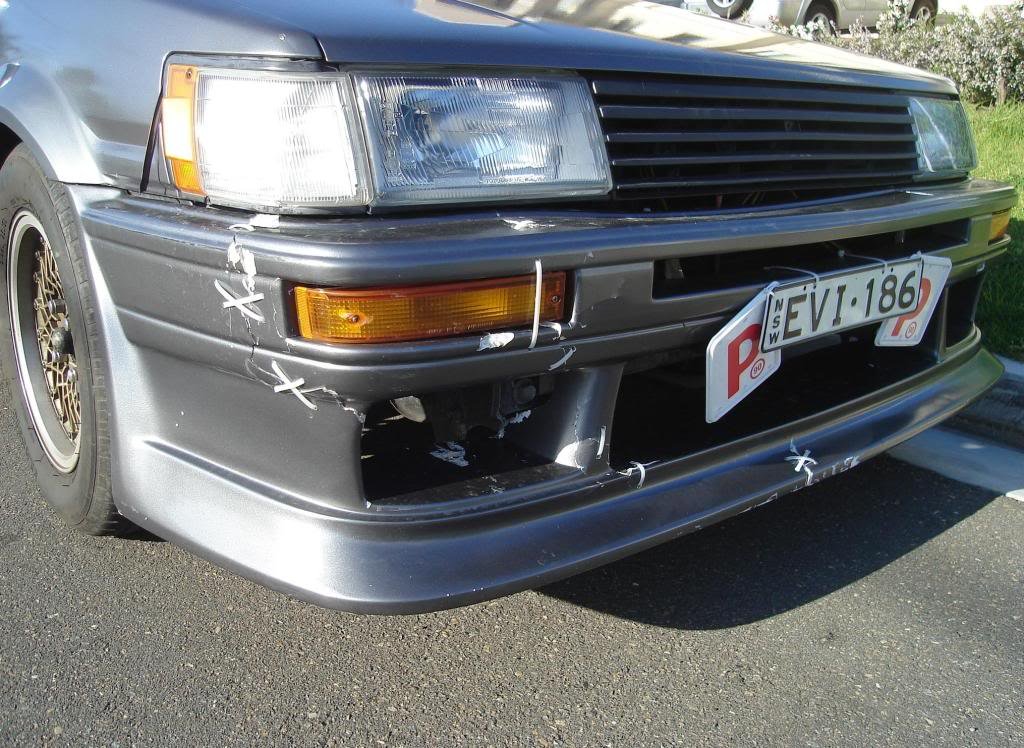

Nice car, however few gaps on the front end fixed and a nice paint job will make it stand out much better.

front bar is suppose to have kouki indicators and havent decide to use them yet so im just running ae82 ones/vertex levin indicators. its been a awhile since i got my car running so i just want to drive it and enjoy it before it comes off road to get a splash of paint.

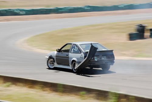

Also attended my first drift track day in my ae86. was ok still gettin use to the car and setting the suspension to suit me. its kind of difficult because im running s13 setup at the fronts with 10kg springs and ksport rear coilover with 4 kg springs. will be getting some 6kg off steriodchicken soon so we'll see how it goes. overall track day was good, got to know the car, drove it how it was suppose to be drive HARD. some close calls with rear bar coming off and got wedge between guard n wheel. enjoyed watching mr n mrs yates and their street car
picture taken by Haikii
thats a classic phouc, nice photo and nice build drive it abit before you take it off the road
well done... let me guess rear bar was just cable tied on?
