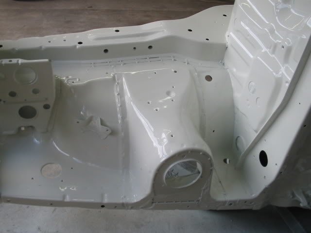

    Default Underbody refresher program

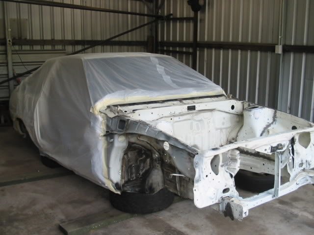

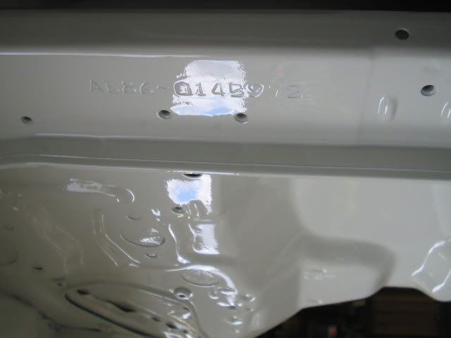

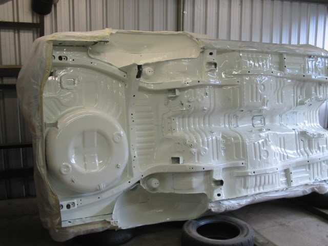

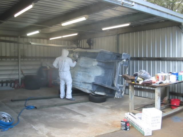

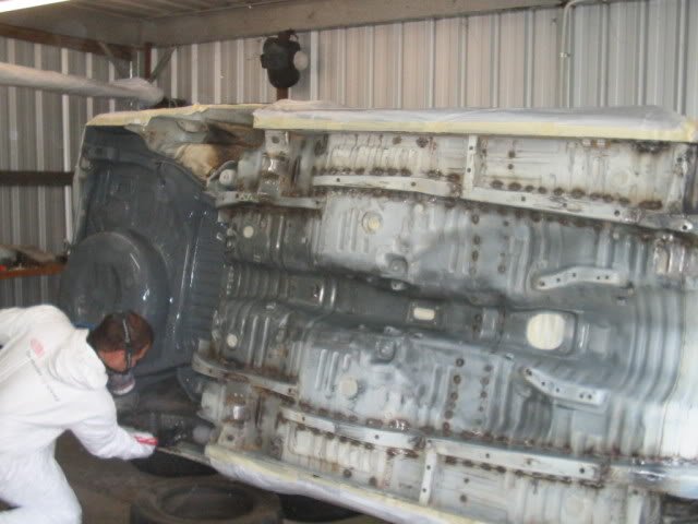

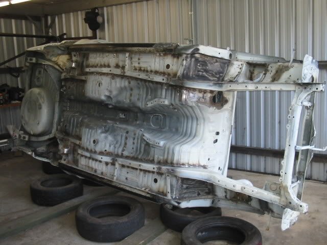

    As you all know, I am disappointed about never being chosen to race in a AE86 series back in the 80's, even if I was only 12. The commissioning of this project should be some consolidation.
    The underbody recieved well over 4351 spot welds and now has the torsional rigidity of a 1991 Honda Accord.
    HDPE masking plastic is used to cover the already prepared interior. I did get my nephew to do some of that after all.
    Stew the painter gets all the etch primer on within a few seconds.
    Only 10min later half a coat of 2 pack colour is sprayed on. An accelerator is added to the hardener. Then a second thick coat of colour is sprayed on.
    The whitest white that Toyota make. Maybe not.
