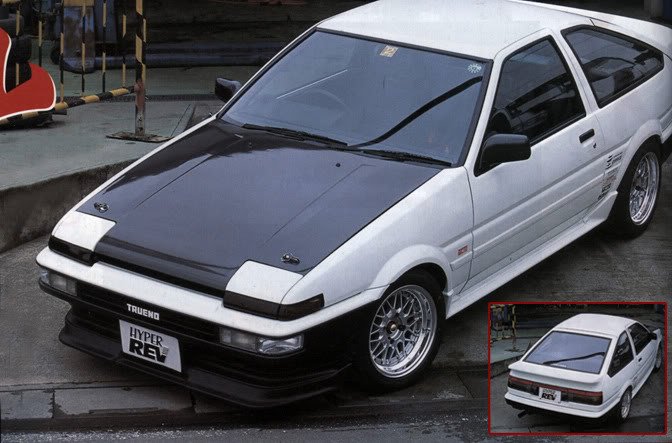

    Here is a spec list of Keiichi Hot Version Trueno ~2002 (and rough translation) some things have changed since isted.
    Toyota Motosports Festival Fuji Speedway 24.11.2002
    ENGINE: AE111 5-Valve 4A-GE (Modified approx. 175 HP)
    CAMS: TODA Racing 272/288
    PISTONS: TODA Racing Forged 82mm
    COMPUTER: FREEDOM ECU (MOTORe Tune/Setting)
    TRANSMISSION: TRD 3-Speed Cross-Mission (Close Ratio 1-3)
    FINAL DRIVE: Genuine Toyota 4.778
    LSD: TRD 2-WAY (Mechanical)
    EXHAUST MANIFOLD/MUFFLER: TRD Custom
    DAMPER: (F&R)TRD AE86 (Blue adjustable short-stroke)
    SPRINGS: (F)8Kg/mm (R)8Kg/mm (Was upto (F)12Kg/mm and (R)10Kg/mm depending on track)
    STABILIZER: TRD (Anti Roll Bars)
    BUSHINGS: TRD Reinforced/Strengthened Rubber compound
    HOOD: M-TECHNIC Dry Carbon Bonnet
    TAILGATE: TRD N2 Application FRP Hatch Wing
    DOOR/SIDE MIRRORS: SHITSUA MODEL Dry Carbon - 350g each (less than half OEM mirror 820g)
    BODY REINFORCEMENT: Tokyo Kagaku Toso Inc. (As seen in video posted above)
    MAINTENANCE: MOTORe (TRD's Sakurai)
    BRAKE: (F)MZ21 Caliper & Disk (R)OEM Disk
    BRAKE PADS: IMAGE (F)C2 (R)Super-Sports
    WHEELS: SSR Dori Dori Mesh 15x7J offset -2
    TIRES: BS Potenza RE-01 195/50R15
    WEIGHT: Approx. 900KG.
    Tsukuba Circuit Best time: 1' 06" 94 (S Tire)

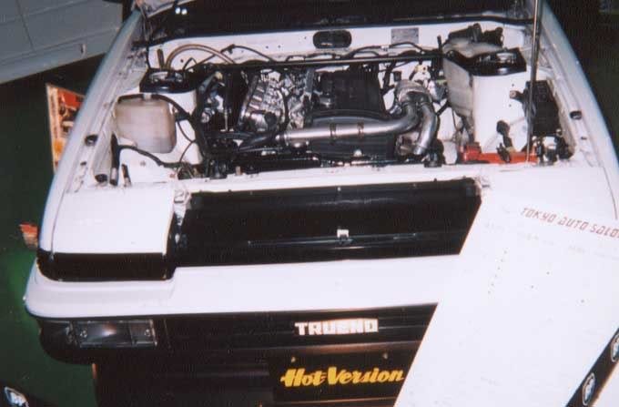

    Here's a very early pic of the Trueno engine bay from the 1999 Tokyo Auto Salon.
    (before the body was restored/repainted and the water lines ran over exhaust)

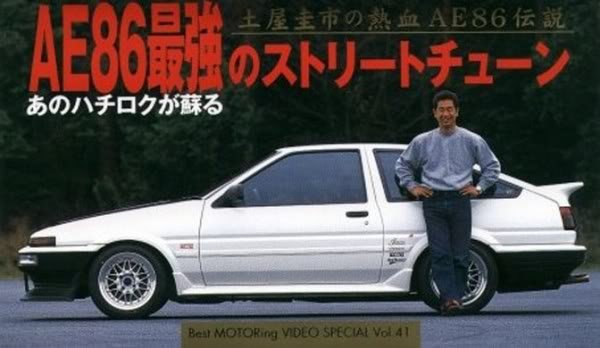

    Best MOTORing Video Special #41 (ignore the title) See related vids for parts 1-6.
    This introduces the Trueno project in detail and also features some now familiar faces (but very young!)
    Kumakubo "Kuma" Nobushige (2006 D1GP Champ, K-Style, Team Orange & Ebisu owner)
    Taniguchi "N.O.B." Nobuteru (2001 D1GP Champ, HKS factory driver, Super Taikyu & JGTC)
    Kawasaki Shunei (SS Works driver, accomplished racer, Best Motoring guest driver/presenter)
    Iida Akira & Orido "MAX" Manabu aka "Mito Natto Racing (Soya Bean Racing) both Super Taikyu & JGTC drivers, Video Option guest presenters.
    Orido also co-judges in D1GP events.
