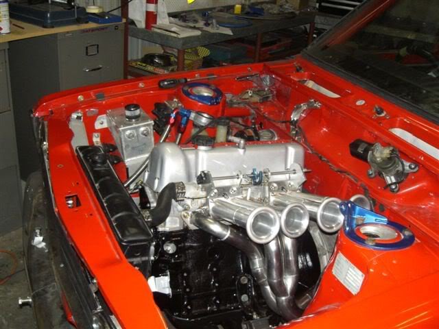

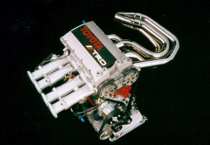

    the longer they are the more torque you get, too a point obviously. the harder your engine revs, the shorter stacks you need. here it should be noted, on the grand scheme of things, 4ages dont actually rev that hard. so youre really wanting the longest stacks you can physically fit in most cases. 20vs are at an advantage here. ive seen tests done on fairly normal 4 cylinder engines, and basically, the longer the stack, the more power it made, these were ridiculously long, like 200mm or more.
    the taper helps the venturi effect as well. so tapering all the way is better than just straight with a bell on the end. ive heard very experienced race engine builders say 7* is a good amount.
    a full radius on the bell is better than just a slightly flared end. your engine will be pulling air even from behind the bell, so this helps to get more in, less turbulence around the rounded edge than a sharp one.
    the material isnt really important. think of that last. i guess there could be arguments about laminar flow like inside the ports (rough v's smooth) but thats beyond the point of worry about. funny to note black top throttles are a flexible rubber. where as silver top are a rigid plastic. but anyway, dont worry about what theyre made from.

    heres some pics
    datsun L motor. makes some ridiculous amount of power (well over 200hp)
    older FA engine. remember. this 4age runs to over 10,000 rpm. yours will be lucky to see 8000. following convention, if anything, you want longer stacks (if you can fit them)
