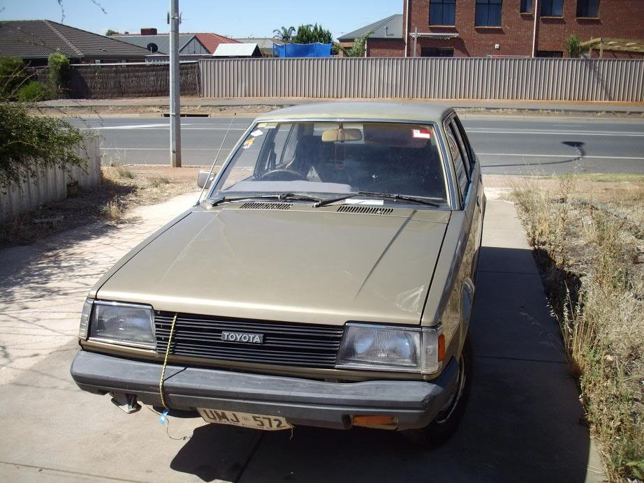

just thought of something, are you sure it's an ae71? hey post some pics on here
Hi Sam, thanks for the info. Checked outyour site, will have to spend me time doing some reading in your artices section. Here are some pics of the car, it says AE71 on the vin no etc so i assume that what it is. Let me know if iots otherwise.
can you post an engine bay pic? specificly the passenger side near the crossmember
if it says ae71 then it's that unless someone has been very sneaky with a grinder which I would doubt
