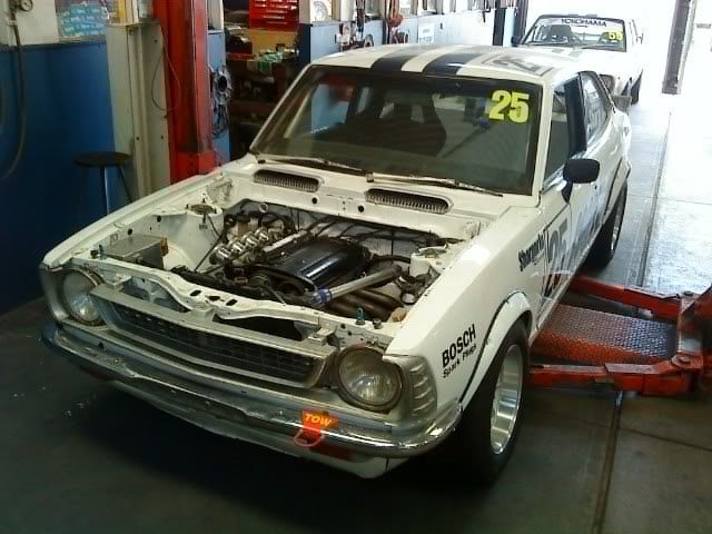

    Tally I would paint it white and run flares with some decent offset wheels, white easy to paint and body isnt as critical and that bamboo colour IMHO is horrid. Decent offset wheels and flares give the rolla a menacing stance.
    Go a high apacity for added visual impact
    Tally if your interested my brother will be selling his 20v drivetrain out of his
    IP car package to suit a ke20-25. It consists of 4age20v S/T dynoed at 110kw, comes with trumpets ,trd copy extractors, extreme lightened flywhee land clutch. T50 gearbox. K series lsd with disc brake conversion. Its all bolt in mate and will make your car a very quick little streeter. Similar
    performance to a ss commodore in a straightline. PM me if your interested.
