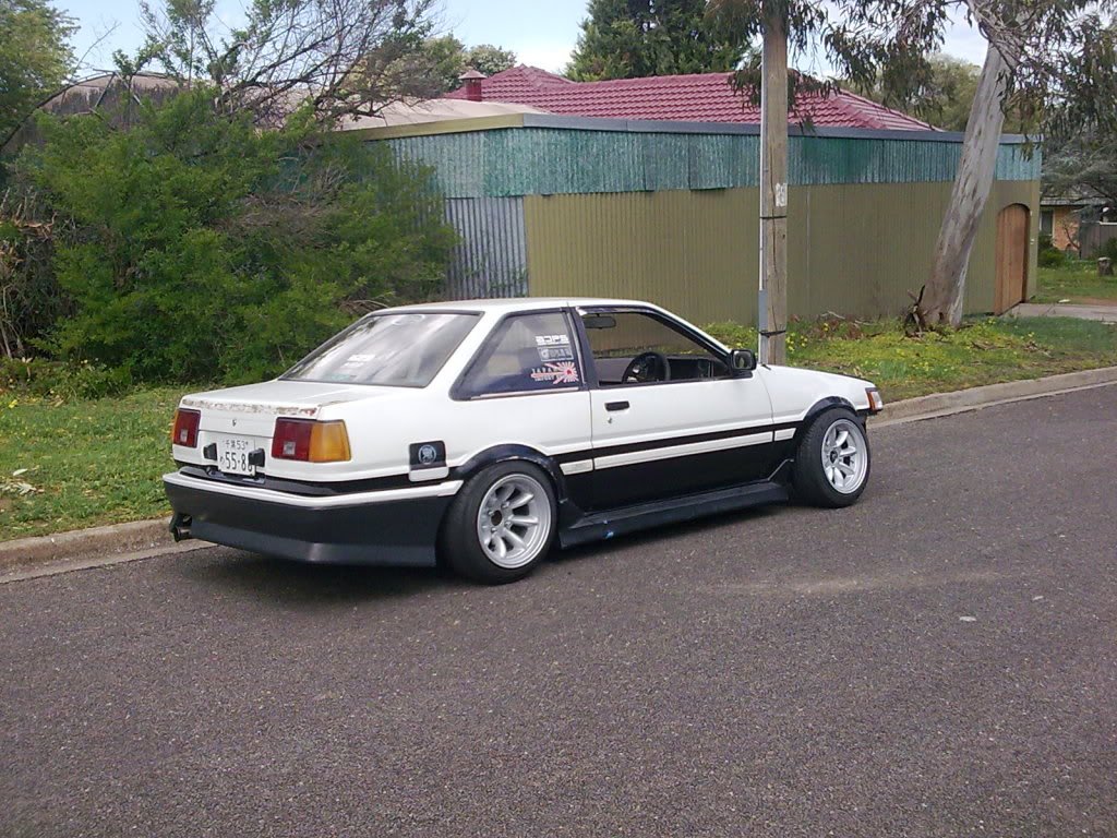

15 x 8 -4 all round
stolen from touge boy
that pic doesnt show them fitting properly. Panhard was unadjusted and poking 15mm towards drivers side, and I had Sigma LCA's in there.
Try this one...
Panhard adjusted, Buddyparts Adj. LCA's wound out 10mm longer than stock, 205/50 on the back, 195/50 up front.
sorry Ben
I still think the top pic looks cooler. even if not so accurate
