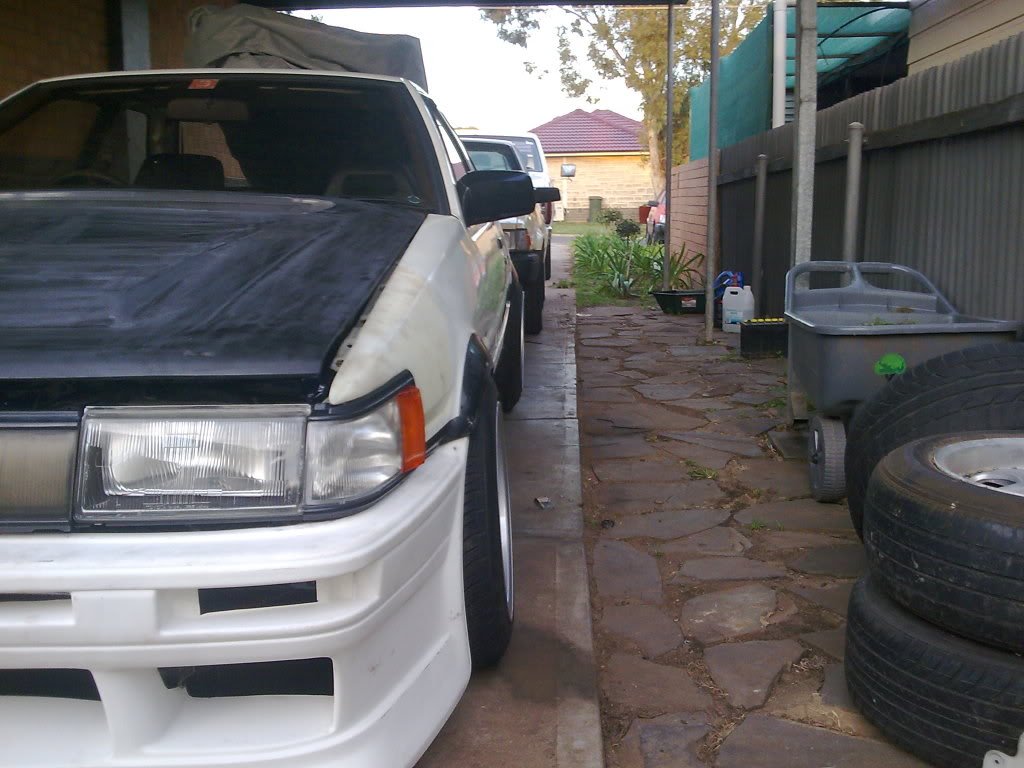

15 x 10 -12, 205/50 tyre, T-Series rear end, centred with adj. panhard rod, pulled and flared guards.
Now have 15 x 8.5 -6 and 15 x 9.5 -19 RS Watanabes, running 195/50 tyres, and pulled the rear guards a tad further so i can go a lot lower. Cutting vertical lips of my new front guards and then flaring so i can drop the front even further. Aiming for a 1.5-2 inch further drop all round.

well...its here....time for a hell of a time trying to make this fit ............
