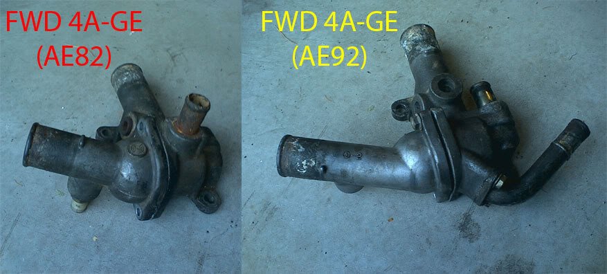

    was told motor was converted but later found out it wasnt still all fwd components, is there a way to customize them to make it work?
    can someone point me in the right direction? a good site, some pictures
    for example found this on daveys blog
    would this work on NA smallport 16v? although i have the ae82 thermostat?

    copy the first picture and your set

    thanks man so i need an ae92 thermostat housing instead of an ae82 as i have already? cant make the 82 one work?

    and this is fine on an 4age no difference in 4agze example?

    yeah easy to adapt, here is a diagram for you:
    all it means is a slight change of hosing
