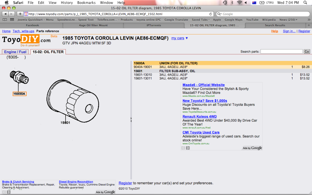

the filter has a rubber O ring on it, and yes it will seal itself. as long as the machined surface is nice and flat you wont have a problem. please remember to lube the two mating surfaces (hehehe) with some oil before tightening the filter onto the thread, otherwise you will have a hard time removing it at the next filter change.
