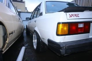

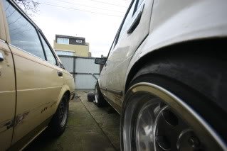

    ive already done some work on it, all the jap stuff of the te71 is now on the spirit, as well as the 1330mm hilux diff and the 10 inch wheels.
    ANYWAY, heres the pics

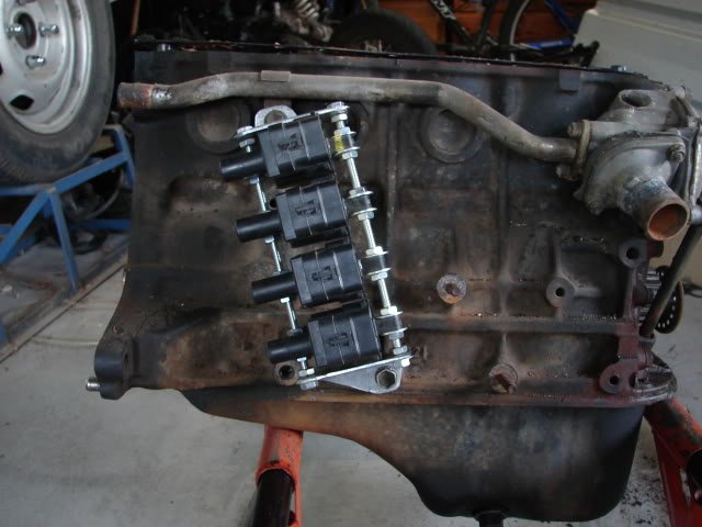

    LS1 coils mounted under inlet manifold

    As you can see in the photos the wheels listed below actually fit under the stock flared guards without and issue. which im stoked about! 10's under stock rolla guards ftw
    wheels are American Racing Baja 15x8 neg 19 for the front using r1r's mainly
    15x10 neg 43 for the rear running 195 50 15
    Any poor alcoholic knows how big a 500ml amsterdam can is
    15x10 neg 38 Cheviout Armourlite (centrline style) 205 50 15
    15x8.5 neg unkown american flower style wheel, very light, one peice.
