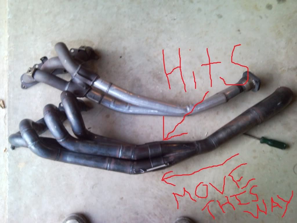

the trd race pipes are for hi comp pistons and big cams quad throttles etc major clod, and the others that they sell seem to snap on the header flange as my mate has had these welded up 9 times now and the facing plate also buckles being stainless

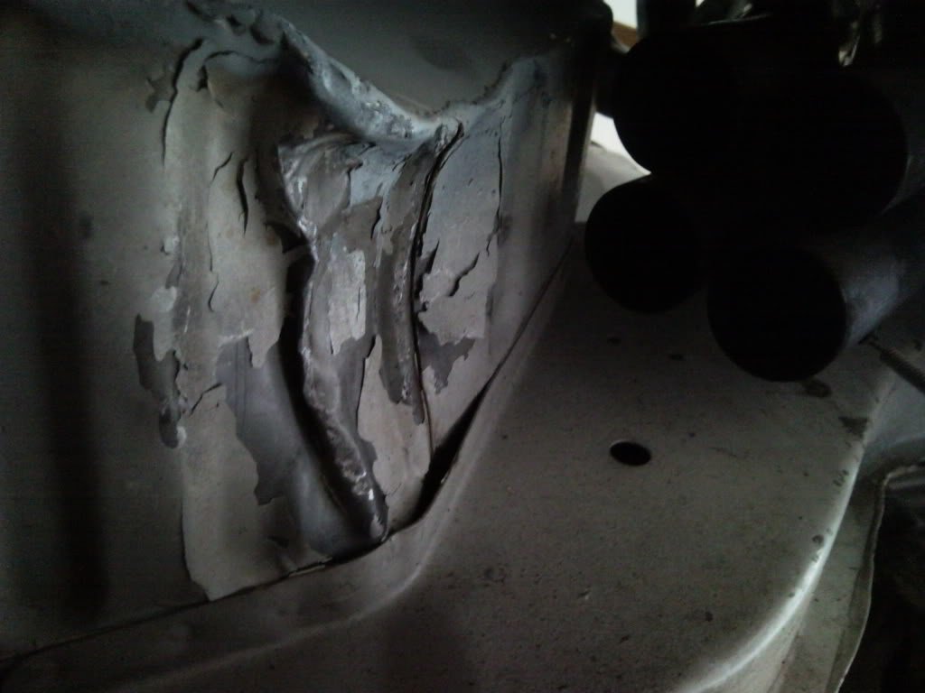

heres the massaging to the body i had to do to fit glens headers. (other half is off getting welded atm)
this is where it hits in relation to the manifold itself.
you welcome to buy my old manifold that i made...
clay you could have straighten them up a bit then cut the merge and reweld .i see what the problem is and my motor is 10mm off the fire wall as well
so where the four change direction just before the merge they should have been straight and would that have fixed your problem
Glenn, do you know the approximate lengths of the primary and secondary pipes on your TRD headers?
