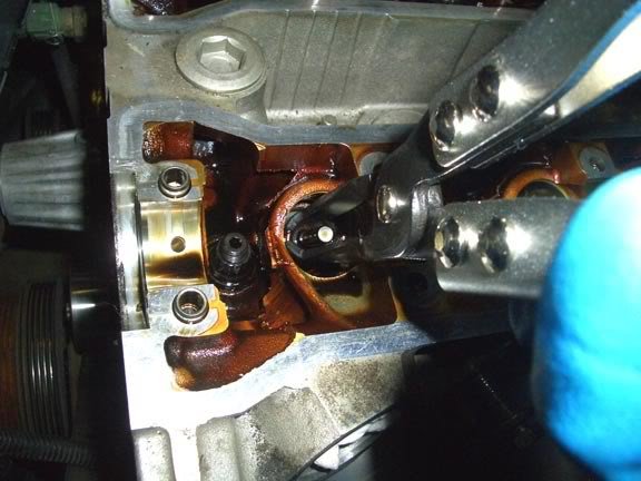

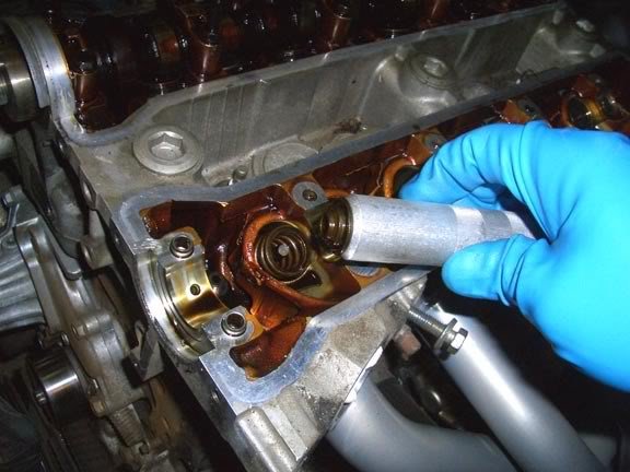

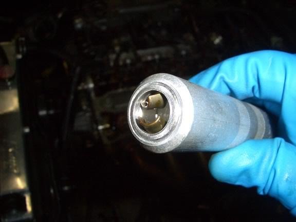

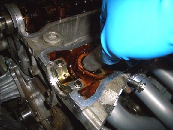

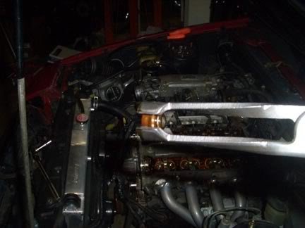

the bluepoint tool GA317 costs ~$70

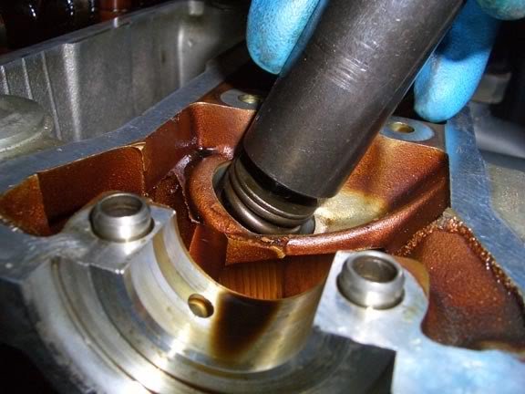

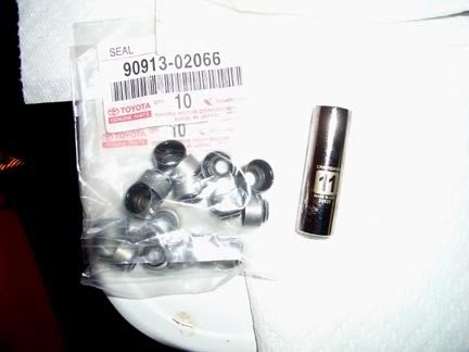

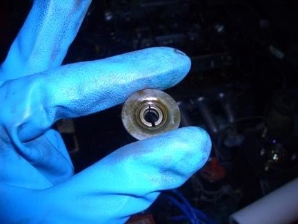

valve stem seals to me were $40 (ACL list them as the same as 3sfe)
the do hickey to hold the valves up was $30 odd
