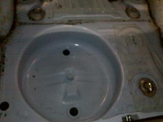

ok day 3
stripped the trunk and finished taking of most of interior... minus front dash rear seatbelts cause my shitty ratchet lost a fight against a tough nut... ( buy good tools guys >< )
also did some cleaning of most of the stuff i was able to take out

i cant really see the stuff your talking about but id say its just excess sound deadening. though i havent finished removing my sound deadening yet so i couldnt say for sure but ive been using a chisel and intend to try and use turps/petrol to remove the excess deadening. maybe use a strong thinner if your gonna paint it again?

and yes foudn out the stuff is soud deadening and a good way to remove it is dry ice and hammer
might try hammer and screwdriver first though since its a cheaper method... im on a tight budget =P
