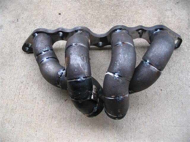

Turbo mani in its early stages

- Custom turbo manifold made by yours truely, SCH40 mild steel steam pipe bends, laser cut flanges, fully back purged and TIG welded

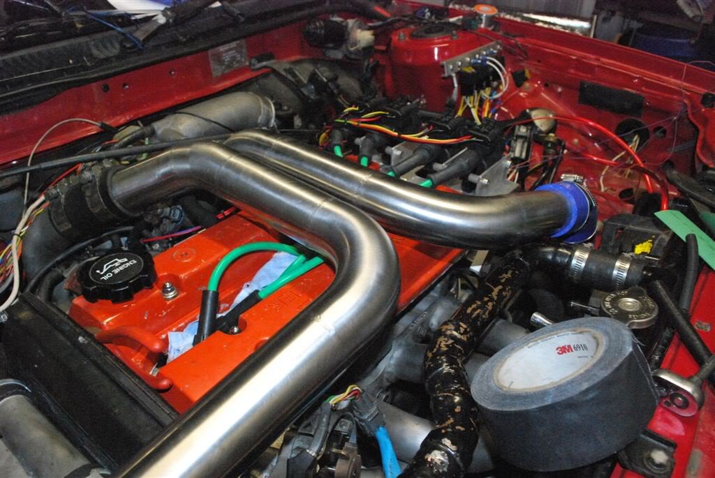

Few more pics of when it was supercharged/ some fabrication pics of IC brackets/piping

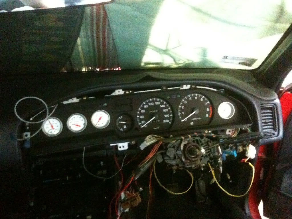

and now up to wiring up the cockpit:
