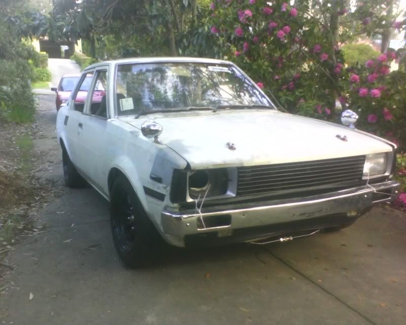

    and so now it looks a tad like this:
    or entirely like that depends how you wanna look at it. anyway as you can see its not finished but its getting close. deadline is oct. 4th for a private day at tailem.
    only thing left is an alternator so if you have one sell it to me. now.
    bought some xr4 longchamps that need rerolling and flipping so hopefully the rear will see more dish.
    gotta pick up my coilovers from ajps when i get a moment.

    feedback is always good.

    weow! updates! looking like a pig should man, nice work.

    Front bumper ziptied on? Painted castor rod brace?
    Jul 2010
    132
    is that wrong? the brackets are bent on the bumper so when i get the chance i'll fix it.
