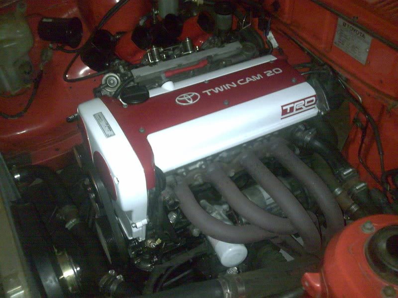

    Anyhooo, this is my drag, drift, gymmie, open track toy...
    Having had a 4agze'd AE93 this was a drop in torque... but hey.. the RWD drivetrain makes up for that
    After going thru 3 x 3t gearboxes Thanks to a buddy connection aka Elton, i sourced a 21R gearbox. Then thanks to another buddy bought a 4a bellhousing, 4agze Flywheel, Clutch and pressure plate, and 3/4 saturday afternoons, i swopped out the 3t for the 21R.
    Had the Prop lengthened and balanced and presto!!! we had liftoff.
    The gearbox was whining a bit but hey... I used ATF and till today it's going fine.
    Then in december last year the Casing cracked right by the oil drain plug , day before Fast n Furious (a local year end racing event), I used a bit of Pratley steel (I'll never underestimate this stuff again!) and it's holding fine now for 9 months!! I just keep my eye on it tho
