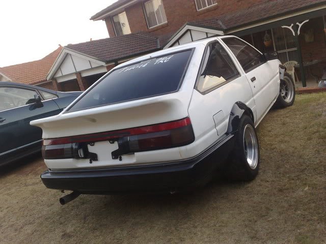

    hey guys i thought id start a build post of my new 86 trueno that i recently bought last week,
    engine:
    8age 1.9L,
    strocked,
    borde,
    fully worked,
    mikuni side drafts,
    soon to be converted to quad throttle injected,
    4,2,1 extracters,
    2.5 inch exhaust
    trd leads,
    unown spark plugs,
    runs electronic ignition with computer,
    will have power reading in the next months but its got plenty trust me lol
    lots more to come ,
    suspension:
    good stuff not telling lol
    coilovers front,
    camber tops,
    rca's,
    lengthand lca's,
    tie rod ends,
    big spacers,
    sway bar,
    rear shocks,
    springs,
    4 link arms,
    sway bar,
    front strut brace,
    rear strut brace,
    more to come soon,
    drive train:
    t50,
    jap diff,
    different rear brakes,
    lsd,
    lower ratio,
    all staying same for now till i start fuckin shit then ill upgrade,
    interior:

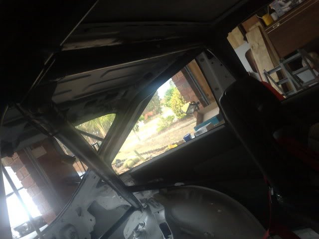

    jap half weld in half bolt in cage,
    stock seats with harness,
    nardi,
    sunroof,
    fully striped interior besides door trims and dash,
    mop from japan to hold the tail gate up,
    will be very different soon,
    exterior:
    old faded whit paint job,
    black bars,
    black bolt on flares,
    red line tail lights,
    duck tail wing,
    14'7 and 14'8?(forgot the name of the wheels)
    potanza semmie slicks all round,
    thats about it,
    will write up the progress and progress pics up later in the month of how it is going but heres some teasers
    hope u like:

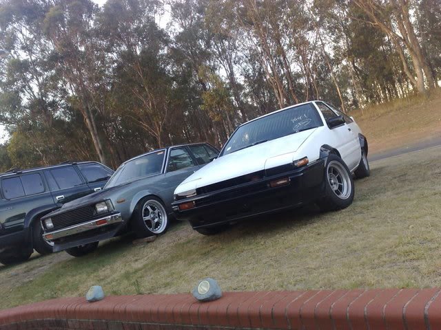

    it sitting next to the grey ke70 witch will be up for sale soon!
    thats if i can let y self sell it lol,
    cage will be up for sale who wants it ?
    nardi going aswell
    and the monster 8age!
    cheers guys let me no wat u think
