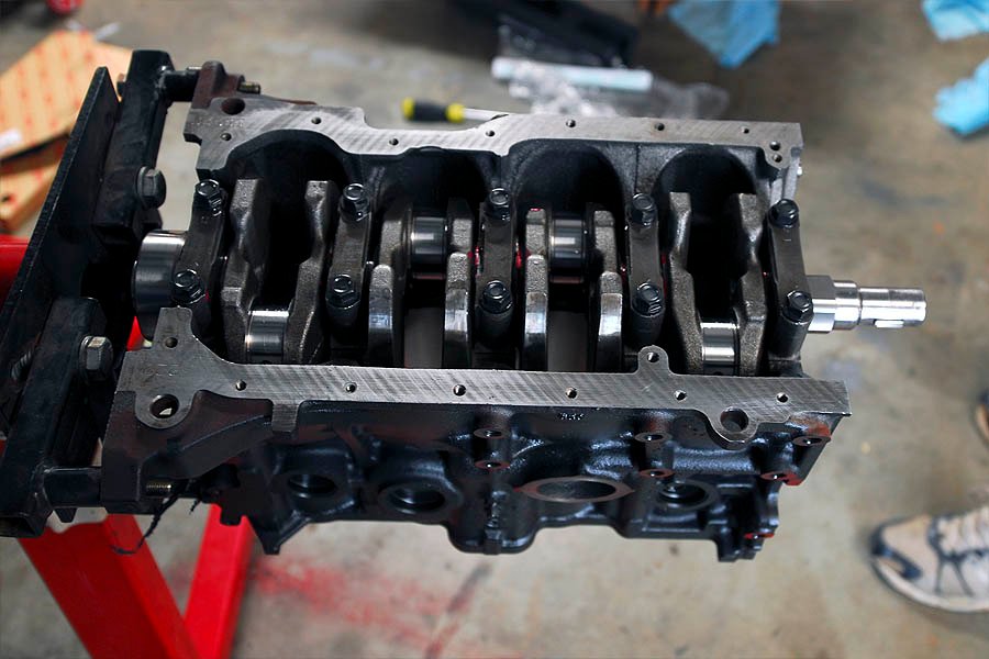

    Okay, 56k users have probably crashed by now, but if not .. please leave this thread. I like pictures more than text, just because they explain everyyyything a little bit better. Here's about 18,000 words worth..
    On thursday evening, a good friend of mine (elliot) called me up and decided that it was a good time to put the motor together. I agreed - apparently he was just coming to watch and make sure i didn't forget anything - but was eventually roped into doing alot more - slave labour is great. There are quite a few steps here we didn't photograph, probably because we were concentrating too much - but these snaps should give you some idea.

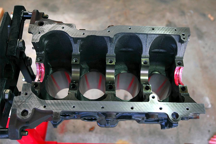

    After cleaning and painting the block, no.1 and no.5 main bearings were installed and lightly lubed.
    A dial indicator (a measuring device that is VERY sensitive to the slightest movement) was setup on the block, and measured the 'crank runout' (aka. is my crank bent?), thankfully everything was well within spec.
    The same wonderful device was also setup inside the crank to measure the thrust clearance. Most people would just do this with a feeler gauge (which is more than sufficient) .. but we had the 'right' tool handy, so we used it.
    Each point of measurement on the gauge = 0.001"

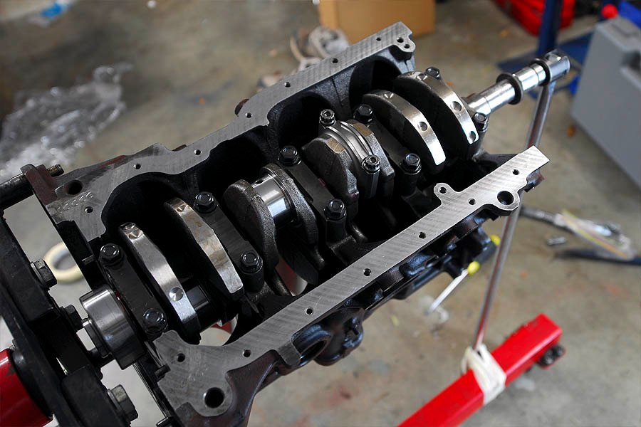

    After checking all the main bearing clearances (not shown), the main and thrust bearings were all lubed with equal parts of redline assembly lube, and elliots blood - no joke, he got pwned, blocks are suprisingly sharp!
    Oil on the thread of the bolts and under the head, and torqued to spec.

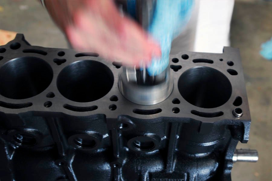

    Using a piston to push a piston ring down the bore (this makes the piston ring perfectly square in the bore)
    Measuring the piston ring gap. Weirdly, the piston rings supplied to me were almost perfect. Little (if any) filing required. So strange.

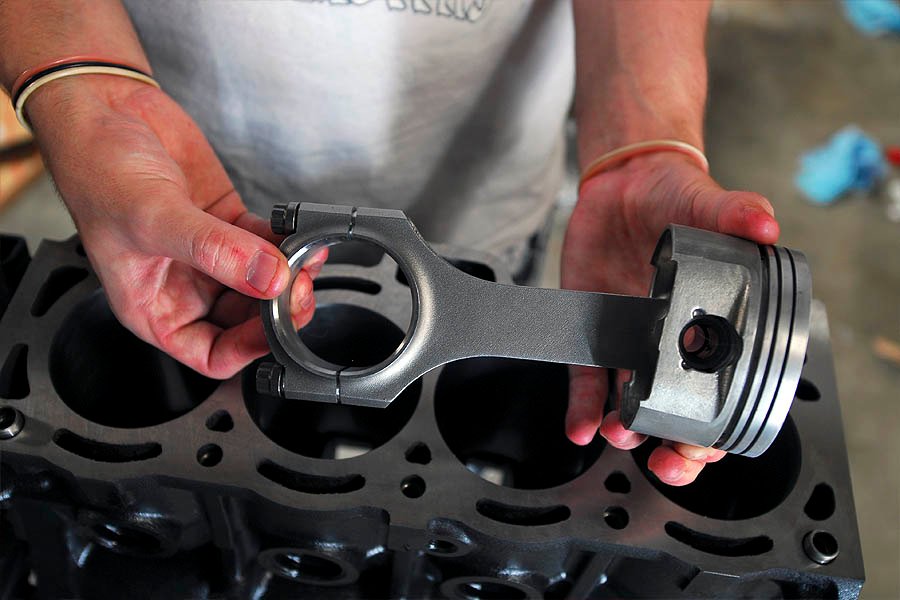

    The first JWorks rod in all its' glory. No, it isn't really THAT chunky, my hands are just similarly sized to a toddler/young girl.
    We used a (long) breaker bar taped to the engine stand to keep the crank perfectly stable - important when double checking clearances with plasticgauge.

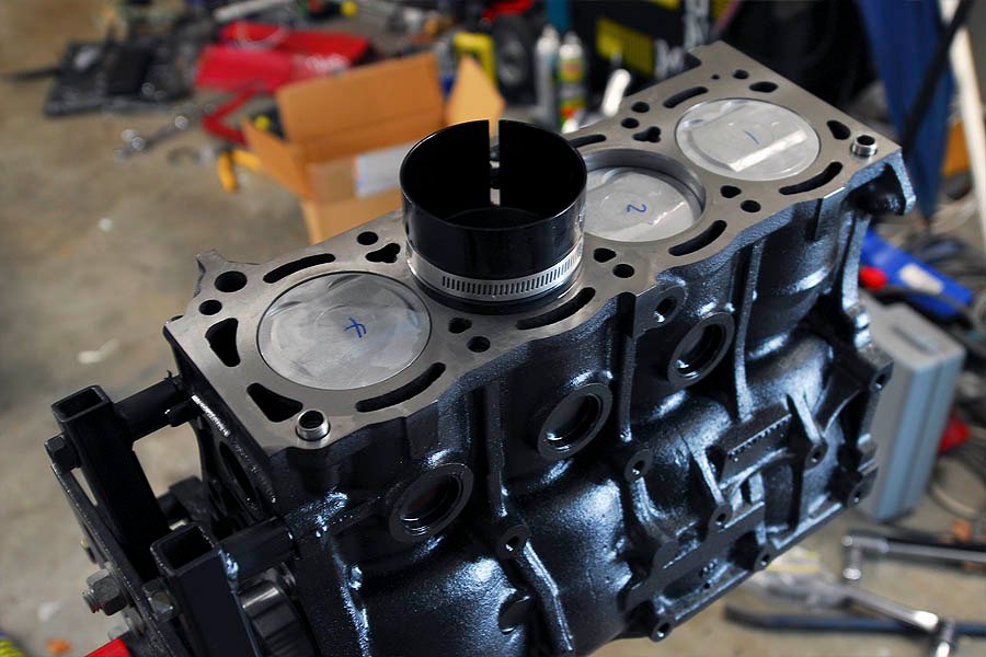

    Honestly, the best damn ring-compressor i've ever used. The only downside? Can only be used for 81-84mm bores - so basically only 4AGE/7AGE .. although in my case that's not really a problem
    Tappy tappy tappy.
    The hektik (proper) way to do up rod bolts - rod bolt stretch gauge. Similar results can be had with a good torque gauge (and honestly, the amount of time mucking around with this gauge was ridiculous), but if you want the absolute best way to do it - stretch gauge is it.
    All assembled .. checking that it spins nicely without catching anything etc.. and it does
    And probably the only important picture - bottom end assembled, and wrapped, ready for oil/water pumps and head etc.
    That basically sums it up. Thanks for watching, and big thanks to elliot for his 8(?) hours of help on thursday arvo/evening.

    Just curious though, when you are putting pistons in, are you starting the skirt in the bore, or is the piston totally covered by the compressor? Not saying you don't know what you are doing, I know you do do
    But I only ever use the compressor on the crown of the piston, leaving the skirt exposed, and not in compression, I can liberally oil the skirt prior to sliding it into the bore that way, also means there is no chance of the piston cocking in the compressor and catching the skirt on the edge of the bore on the way in. I also like to tap the ring compressor down to the bore, that way its in 100% contact with bore.
    How do you do it?

    Haha cheers guys Gunner - i undo the compressor a little bit, and push the piston in from the top of the compressor (to the piston is totally covered), then do up the compressor again. i have scribed a little mark on the compressor to tell me when i've got to the exact 81mm bore size .. but you can kinda feel when it doesn't want to do much more compressing haha. Then basically push down with my fingers until i can feel the piston aligning with the bore.
    Then STOP - hammer time.

    haha good shit. I suppose you wouldn't have to worry to much about the piston not being square in the compressor that way hmm.
