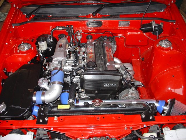

    what kind of bracket are you using for the sc14? did it fit/canit fit on the stock one?

    With the SC14 I have the 1ggte version. This placed the pulley approximately 12.5mm (from memory) too far back to be inline with the pulleys when using the sc12 std lower bracket. My solution was to grind the existing bracket and use a thick metal washer on the front end of the bracket. It seems to distribute the load alright without putting the bracket under any noticeable compression stress. The top bracket is custom made using some 20x3 mm and 20x6mm steel as well as extruded tube. I will get some pictures soonish which will make a bit more sense i hope.
    In the meantime here is what it looks like now, engine bay and boot sprayed, and car disassembled waiting full prime and then top coat.
