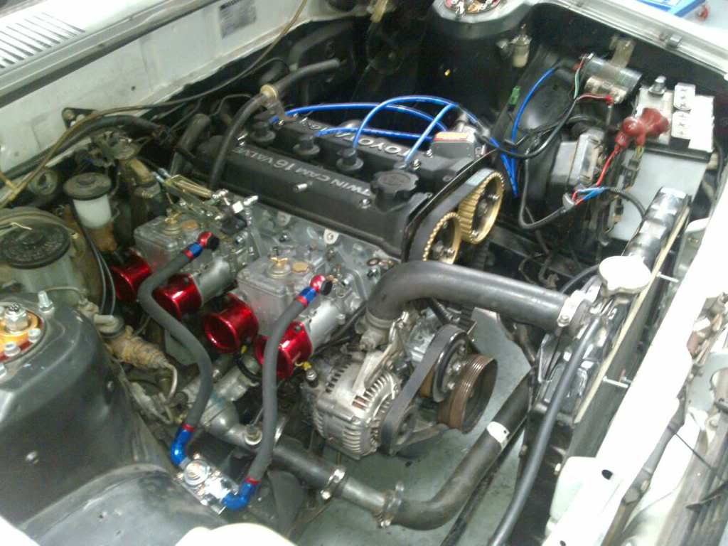

    im finally putting up my car on this site about time lol here it goes its a rolla 70 been building it since start of last year, picked it up for $400 just a shell.
    I dont have much pics of wat it looked like at the start coz of my computer being cleaned out but i guess all of u know how a standard ke70 looks like.
    Its a 4age with 40mm webers:
    Port n polish head acid diped
    800a wade cams
    hks valve springs
    honed out block
    oversized pistons
    everything has been replaced with toyota genuine parts
    40mm webers rebuilt
    redline trumpets
    redline double linkage cable
    ke70 radiator with thermos
    t3 adjustable cam gears
    suspension:
    KYB AGX 8 Way Adjustable Shock Absorbers
    Techno Toy Tuning Coilover Weld on Kit
    Techno Toy Tuning Cambertops
    Eibach 8 Kg/mm Front Springs
    Techno Toy Tuning Negative Roll Centre Adjusters
    Techno Toy Tuning Adjustable Castor Rods
    AJPS Lock Spacer
    xr6 cut springs at the back
    KYB Sierra Rear Shock Absorbers
    Whiteline Adjustable Panhard Rod
    Alignment Specifications
    -3.5 Camber
    +3.0 Castor
    +2mm Total Toe
    Brakes:
    standard 86 brakes
    Interior:
    reclinable bucket seat
    gktech boss kit and steering wheel
    striped interior no sound detanor
    re carpeted whole car with cable ties lol
    5inch autometer tacho with shiftlight
    wheels:
    atm i have ma61 all round
    but im looking for sum star sharks
    exterior:
    front gaurds flared out with multigrips as much as i culd then i went ova with a dolli smoothed it out then boged it for nice shape as u can c in the pics.
    chrome bumpers from a t18
    quadheadlights
    these r sum pics i have that wre still saved on the comp
    will be taking sum reall soon but the car is sitting at status tuning atm.

    went to visit the car at status tuning, cranked it ova started up straight away and sound sik willl be piking it up monday afternoon due to exhaust being made up in monday morning.

    Nice rig mate must sound good with that induction happening

    so tidy inside the bay, looks awesome.
    get some more pics up soon

    tuff as fuk. engine is porn
