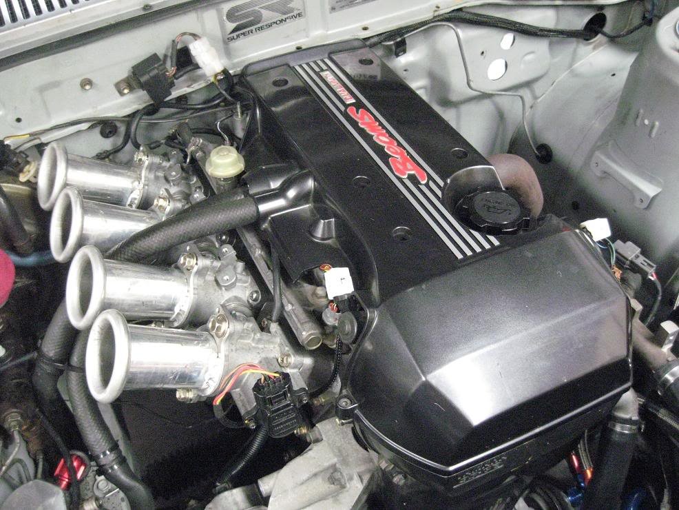

he never really posted any pics of the convertion. just a handful of motor pics.
are you chasing anything specific pat? i think ive got a few pics of his mounts thats it.

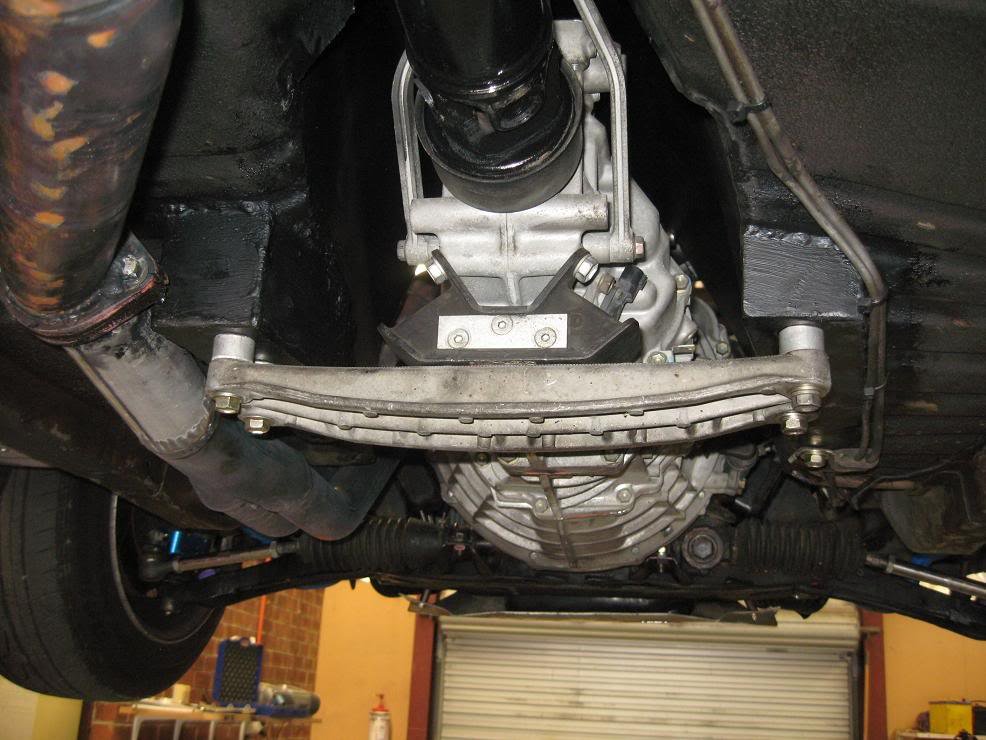

mainly how it sat in the bay and if he built a new tunnel for it?
06/07/2011
yeah he built a new tunnel for it.
its really no different to mine. just appers alittle lower due to the taller engine bay.
wow thats tidy
yeah i vaquely remembered something about the auto box ke70 tunels being bigger and the 6 speed fitte with some mild massaging, but it looks like he built a full tunnel for it .....
06/07/2011
i call bullshit on the auto tunnel being bigger. i dont think they would of gone to the troble of moulding 2 different floor pans.
the issue is the height of the gearbox. it is possable to get the 6sp and beams in the tunnel probley without or minimal bashing.
but sump will hang 2inch further down. you can get as low as andys setup with a wet sump just have to run the car super high. andys tunnel is untouched with w58 and clears by miles i think.
