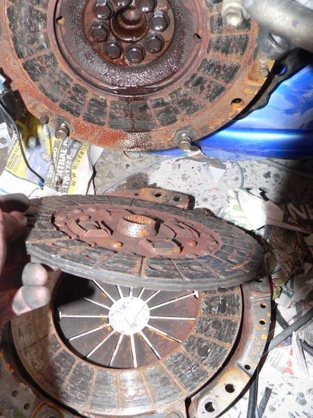

after the flywheel is machined will put it the t50 onto the 4age, clutch still looks fairly new has so depending on how much money i have I'll decide whether or not to get a new clutch or not.
