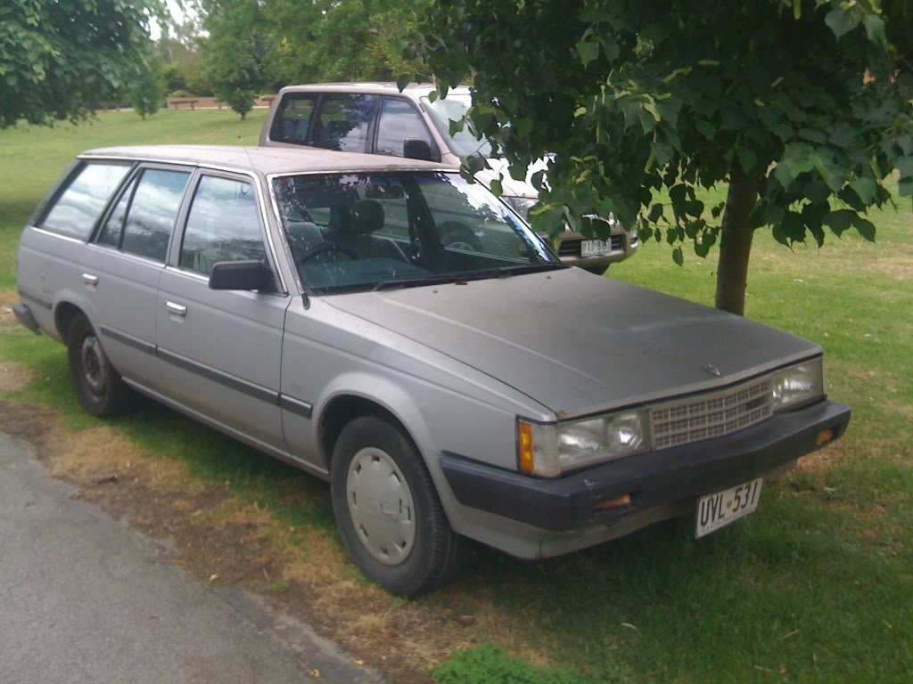

    So i bought a Corona wagon, not just any corona wagon.
    Its a 22RE, 5speed, pretty straight body, needs a bit of work but it will be sweet.
    Parts List so far:
    Interior:
    360mm Nardi classic
    Mad stezza bro
    Bride Brix 1's
    Cusco Knob
    Motor:
    K&N filter
    New leads, plugs, rocker gasket, rear main, rear g/box seal
    Exhaust
    Suspension:
    Front
    Rebuilt rack
    Kelway strutbrace
    Superpro LCA, sway bar and castor rod bushes.
    AJPS RA60 Coilover, 9kg spring
    AJPS RA60 RCA
    KYB AGX 4 way
    RA60 P/S steering arms
    Cusco S13 Cambertops
    EBC Green Pads
    RDA slotted + vented rotors
    195/55 RE001's
    Rear
    AJPS Panhard Rod
    AJPS 7KG springs
    AJPS Adjustable Spring perches
    AJPS Rear Brace
    Superpro swaybar bushes
    TRD Blue 8 way
    Wheels:
    Southern Ways Mesh 15x8 -6, 15x8.5 -6
    Driveline:
    Extweem H/D clutch + pressure plate
    Before:
