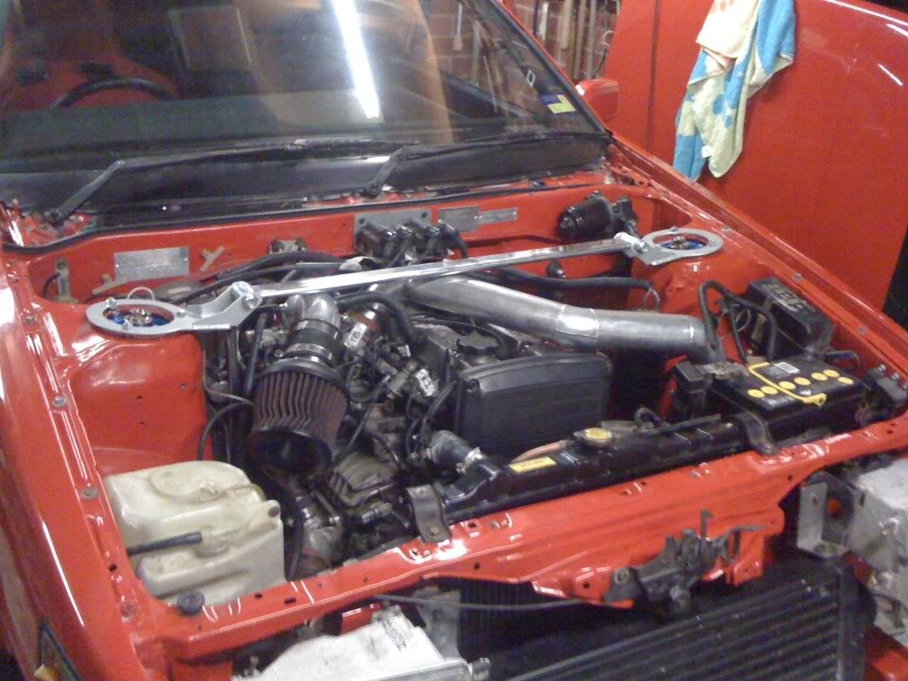

    85 adm sprinter
    Engine

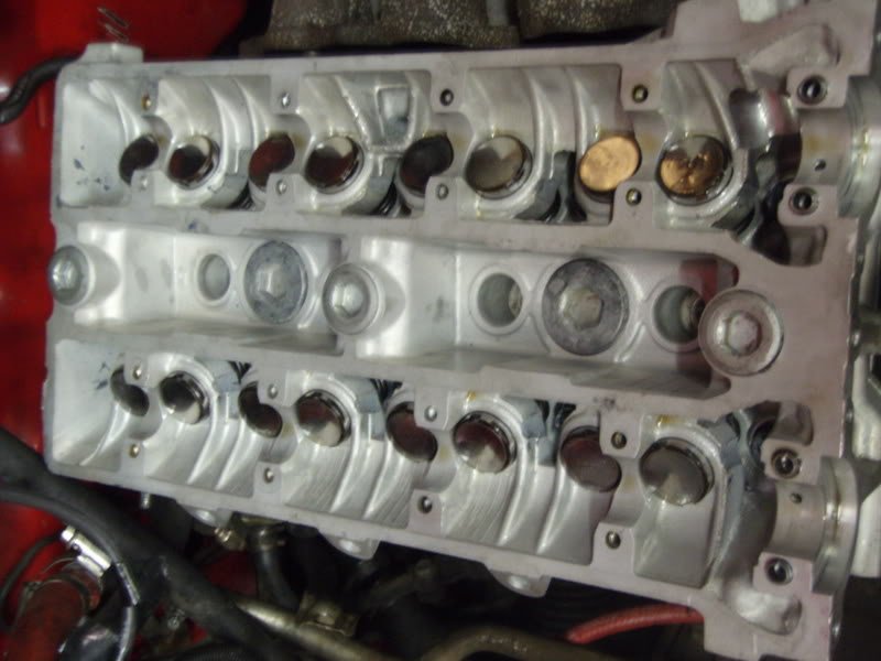

    AE92 gze
    cometic metal head gasket
    ARP studs
    Front mount
    Haltech E8
    driveline
    adm t50 with jdm bell housing.
    t18 diff fully rebuilt with cusco RS 2way.
    Suspension
    stock on choped springs
    Parts ordered
    AJPS front coilovers with bilstien shocks cusco camber tops 6kg spring
    rear bilstien shocks
    4kg rear springs
    Corona arms
    Rack spacer
    ajps traction brackets
    Brakes
    VT comodore front
    drums rear
    Changing to fc rx7 with AJPS coversion kit. Just waiting on parts.
    Body
    Fully reprayed with painted gloss black bumpers
    Waiting on zenki front lip
    and gaurd will be flared soon to fit new wheels
    Wheels
    konig rewinds
    longchamps
    15x8 -4 superlight on order.
    Interior
    Bride zeta
    suede dash
    just jap wheel to replace the one in the pic. changing to a nardi soon

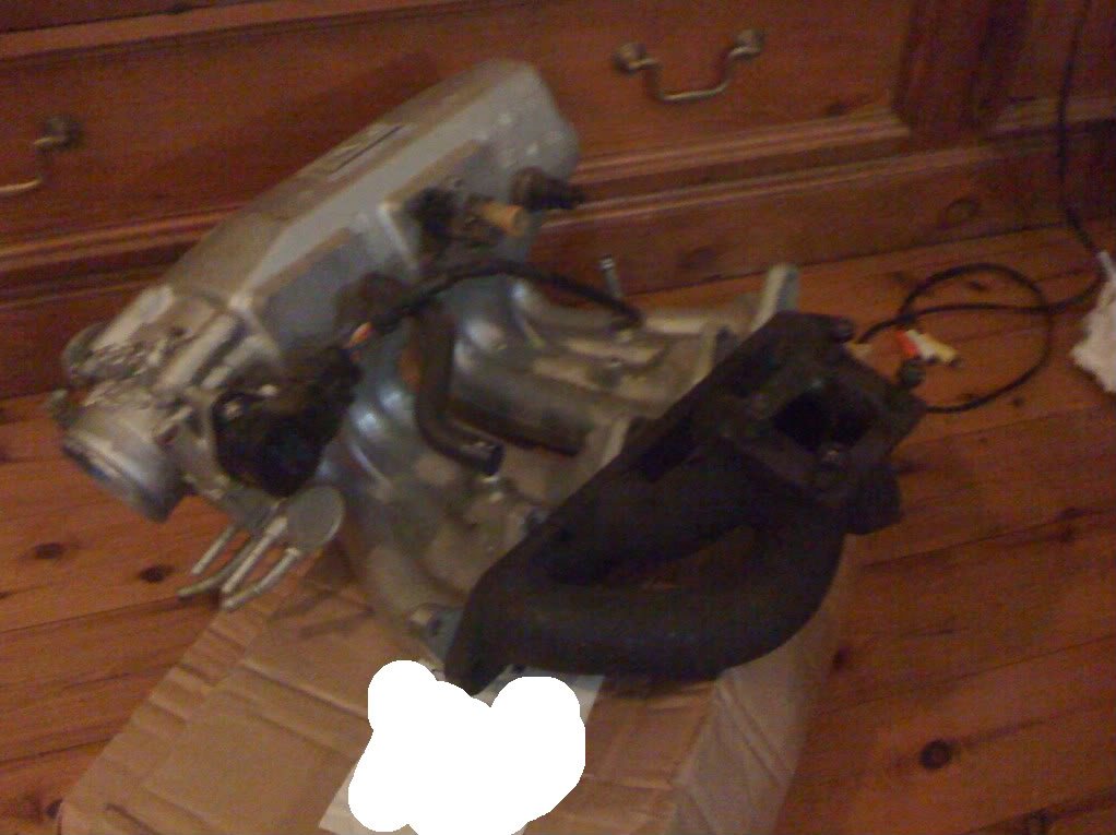

    plans are for a kelway highmount manifold with a KKR280 just waiting on some funds to come through.

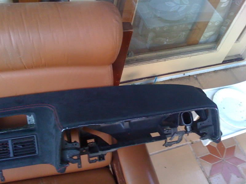

    i love the dash, red baseball stitch looks really good. Just curious how much to get it trimmed?
  • #3
    Stuart
    Nsw
    143
    I got it done by a mate from spare material. If you interested in getting one done. Call Simon on 0414803084. He will be able to answer all your trimming question. I think it's around the $300 mark.

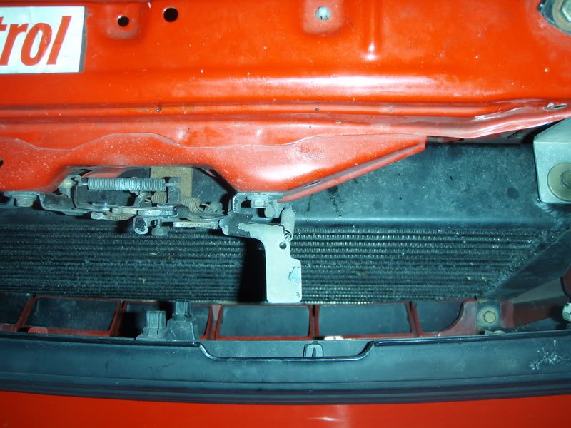

    My wheels, camber tops, front lip and exhaust manifold should be here this friday. if you check the first post this stuff has been a long time coming. Engine is all back in and wired just need some fuel hose and intercooler hose. I ordered a under drive pulley for the water pump and T3's new power steering arms with 2 different setting of lock and if you do the math there aren't much more coin than buying new toyota arms. The aus dollar is pretty strong atm. It should be running on the weekend if i have no more problems.

    Suede Dash
