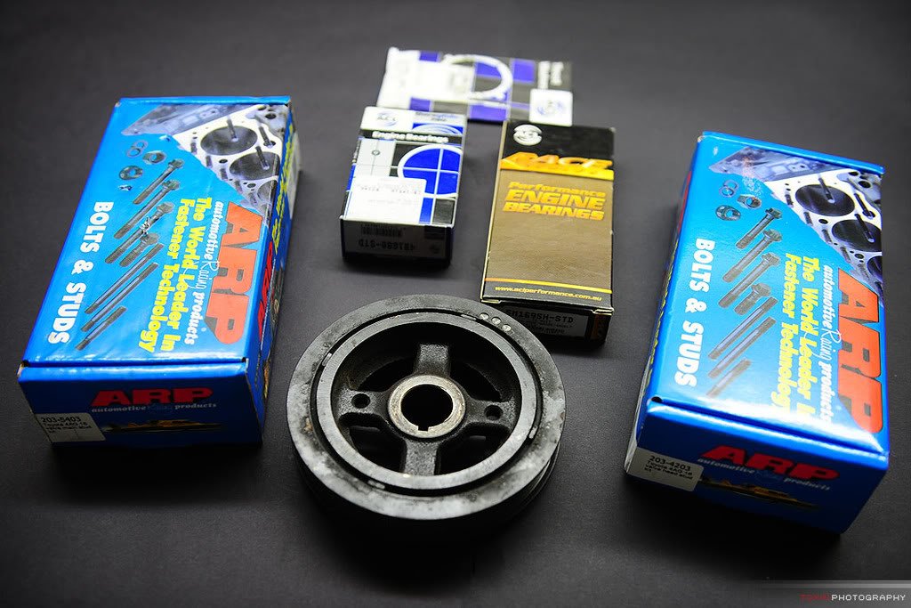

    Most of what will make up my (hopefully) super-strong bottom end.
    ARP Head-studs, ARP Main-studs, ACL Rod/Main/Thrust Bearings, and a super-special single-belt harmonic balancer (I really don't believe in the all-alloy version of lightweight "balancers")

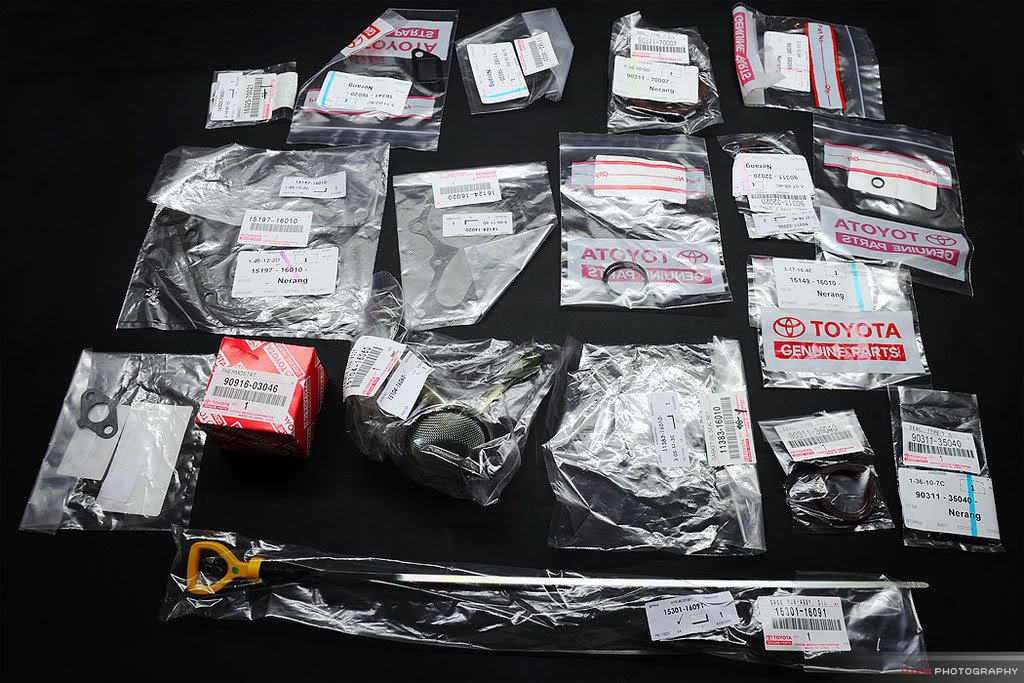

    Box of goodies from Toyota
    Yeah, exciting stuff like a dipstick, oil strainer, and gaskets and gaskets and ga..

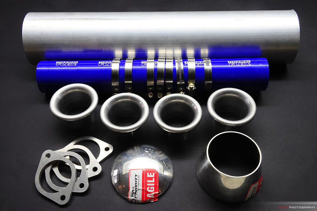

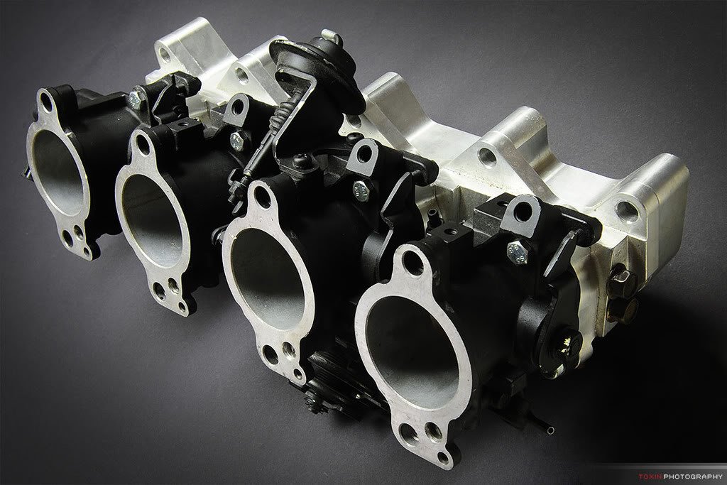

    AE111 Blacktop Quads with some Japanese custom adaptor plate. As something slightly different to the norm, I will be doing a quad-throttle turbo setup. I know a ~90mm throttle body attached to modified stock plenum would probably be the most power-productive, but I’d rather do something a little interesting.
    And to make the plenum, I have various bits and pieces, will hopefully be nice! My main concern is clutch/brake master clearance, but I guess it can't be too hard.
    The trumpets fit the flanges pretty well, not even a mm overhang.
    And what I’ll also be welding to the plenum, TIAL's newest 'Q' BOV.

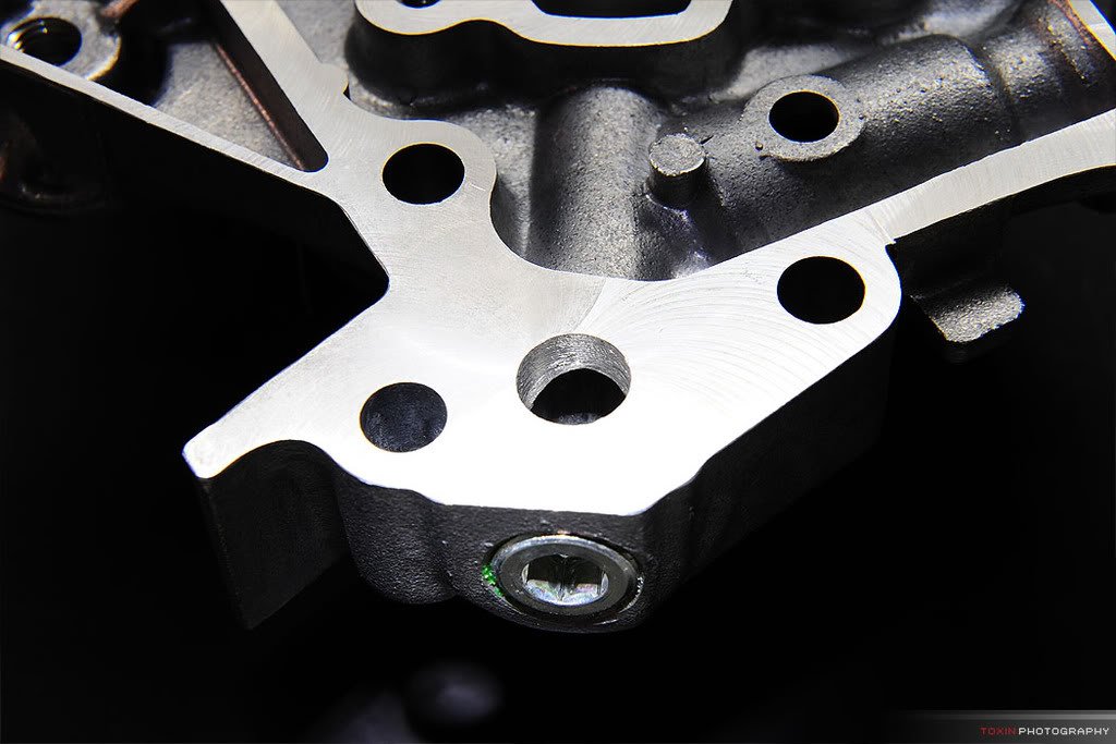

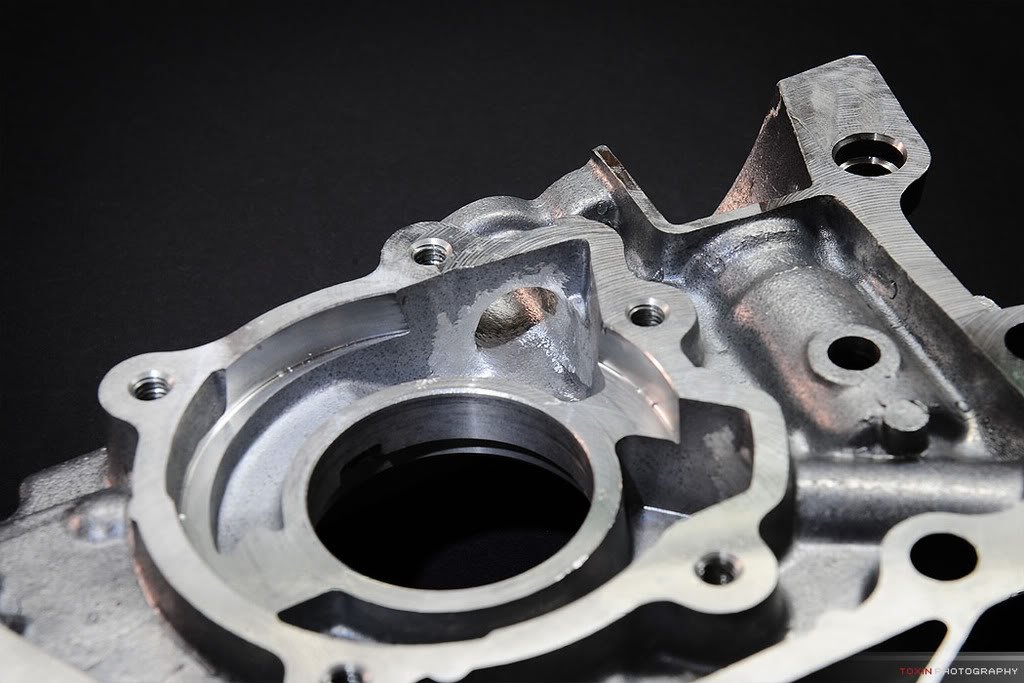

    Oil Pump Porting.. Ergh
    Okay, another one of the stupid little things I just 'had' to do was port the oil pump. This won't increase oil pressure, and won't even really give any power gains, just hopefully improve durability. Less oil restriction = less stress the gears are under to make the pressure = win. The 20c coin should give you an idea how tiny the tungsten (left) and diamond coated (right) bits are, they are basically only suitable for little dremels (3mm shank), and are REALLY easy to handle.
    Standard oil pump, disassembled
    Little diagram I made up, hopefully it makes sense.
    Okay, so here's one of the standard ports.

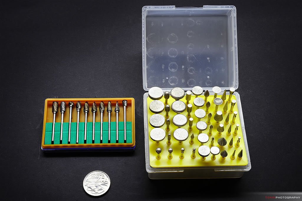

    After fifteen or so minutes with one of the tungsten pieces, it got to this stage. Finish wasn't really as rough as I thought it'd be.
    Then a little more with the diamond-coated bits, and it was good as done.
    Another one of the ports
    And finished. Nice.
    The third and final port was difficult to see at best, I didn't bother documenting it for this reason, but it got the grinding-treatment too.
    The oil-relief valve, spring, etc.

    Why did you port the oil pump.???
    I understand your theory.
    But the instant the oil leaves the pump it has to travel down meters of tiny oil galleries that are full of horrible square 90* turns and such...
    Guess it makes you feel good though knowing you've done it...
