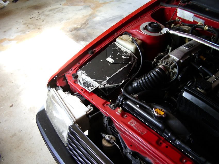

    Im running a cold air box which was made to fit behind the drivers side headlight.... fully inclosed (K&N pod) has a hole in the bottom that has induction hose feeding from the front bumper into the box...
    the box is just made from sheet metal bent into shape with a lid held in place by a few screws......
    was made quickly for blueslip... planning to make another one similar out of aluminium and more pretty....

    This is what cured my boredom this morning.
    I found an old sheet metal carry all/tool box I'd made back in year 8.
    I was thinking about cold air induction this morning and happened to stumble upon the old year 8 metal arts project.
    So I got to work, bending and manipulating it to sit over my filter, allthough I really need a longer intake pipe as it doesn't really sit over my filter apart from just on the end, it will probably just redirect air to it, my catch can also sits under there.
    I'll probably grab another big bit of sheet metal and remake it. As this one was just a mock up, which actually turned out not too bad to my suprise. Then cut a hole under it and maybe run some piping or just run some from the front bar.
