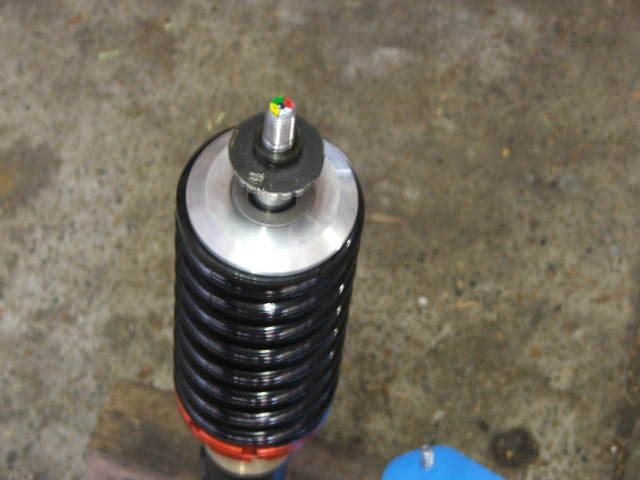

AJPS front coilovers
cusco camber tops
AGX 4 adjustable short stroke shocks

hows the suspension like?
what dampner rate do u run?
nice, hows is ur oil cooler set up eg. sandwich plate
coilovers are good,had to custom modify thou,
dampers are set on 2 and are quiet nice for road use

what do u mean custom modify? cut springs?

nah had to make custom spacer between the cambertop and the top of the shock
otherwise the cambertop doesnt have enough movement as well as the shock smashing the cambertop
3 cars i know have done this
