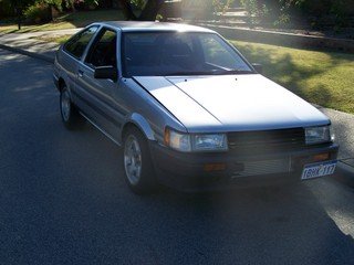

Hello all Hachi owners. Thought you guys would be interested in checking out my little 86 that could.
It is an unfinished project that has the most bulletproof driveline i could find so it is easy for me to finish off.(atleast all the fabrication is done)
SPECS:
MAKE: AE86 Levin
INTERIOR:
-Battery relocated in boot
-Battery isolator
-Fusebox behind centre console
-Fixed back bucket seat
-Glitter dildo knob
-No stereo(purely performance haha)
-Charcoal hammer finish
-Speco oil, volts and boost gauge
ENGINE:
-AW11 AFM 4AGZE
-Block rebored 20 thou oversize
-Stock headgear
-Every single seal and gasket replaced
-Balanced rods
-7MGTE injectors
-Rebuilt Garrett T28 turbo
-Extreme 4Puck button clutch
-Custom alloy radiator
-Custom made FMIC
-Remote mount oil filter
-Skyline brake booster and master cylinder(straight bolt in item.)
-10mm stainless fuel lines
-custom rad support
-Fully sick stainless steel lobster weld IC piping(actually really shit as i did it)
-GFB manual boost controller
-10" Thermo fan
-Mushroom Pod filter
-GReddy E-manage(not installed yet)
-Bosch 040 fuel pump
-1.5L surge tank with Speedflow fittings
DRIVETRAIN:
-Rebuilt F series from and MS112 Crown with torsen centre
-New bearings and seals
-T3 5 Link stud conversion
-Watts link
-Rebuilt Supra five speed gearbox(W57)
-Bill Sherwood bell housing adaptor
-Modified tailshaft and Porsche unis(this is about 10cm wide!!!)
SUSPENSION:
-Adjustable Panhard rods
-Koni's and Lovell's shocks and springs
-Whitleline swaybars
-New nolothane bushes
-Nissan Skyline GTR twin rotor four pot calipers on custom T3 5 stud hubs brakes up front with brembos
-Twin 300zx single caliper's with DBA's on rear
-New brackets
-New bearings
EXTERIOR:
-Complete set of Whitelines
-Fully sick garden edging front lip
-Ford ZR4 15" rims
-SSR Five stars
-Meathead #1 tyres
-Bonnet pins
All in all it's an absolute bullet proof package which i was after because it needs to stand up to the punishment of drifting.

pics or ban!

There should have been a pic there. i'll upload some later on today
