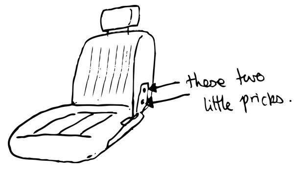

    I'm not too sure what you mean exactly either. If you want to completely remove the rails / reclining mechanism from the seat from memory it's fairly straight forward. Like Marvis said it's pretty much just a few nuts and bolts. The one area that had me stumped was the metal bit that went into the back part of the seat. Like in this sketch I drew below. There were 2 (I think? can't remember) nuts in there that were mega hard to undo because the fabric was fairly tight around there. lots of WD40, swear words and a ring spanner were used to get them off. I can only recommend the same haha. Hopefully this makes sense.
    P.S - I can't remember if there were 2 more on the other side of the seat. If so, do the same on both sides

    lol, thats the one, thanks all
