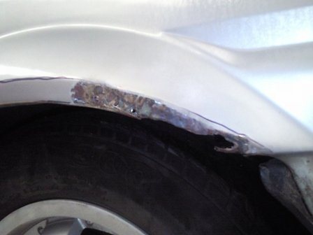

    ATM i'm really just concentrating on getting all the rust out of the car as it was pretty bad and i'm cleaning up the engine bay more. Should have some pics up tommorow.

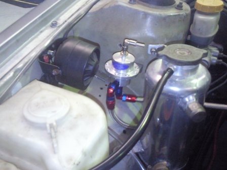

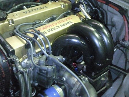

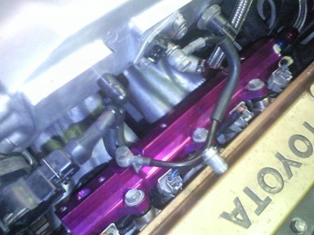

    Been a while since I have updated but I'm busy working on the 86
    Changed a lot of things in the engine bay as i wasn't happy with most of it but after spending alot of money and time on it i'm really happy with the end result.
    -Repainted manifold high temp gloss black
    -Repolished inlet manifold (thanks Lisa!!! )
    -Hid majority of wiring loom
    -Painted fuel rail anodised purple
    -Relocated oil filter with speedflow fittings and SS lines
    -Installed SARD fuel reg with aforementioned lines
    -New brake booster line
    -Fitted RWD alternator bracket
    Got my mate welding the mount's back on for the fuel tank at the moment and are hoping to weld the rest of the rear end up by the weekend and have it bogged.
    I'll let the pics do the talking now

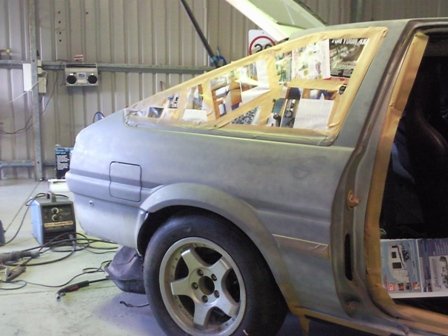

    Got a fair bit of body work done on my car today with the help of a mate who's in the first pic. Still have to finish welding the boot up and bog it then respray the rear quarters hopefully tommorow. Progress is moving along quickly and hope to have it running next weekend when my RWD water pump arrives.

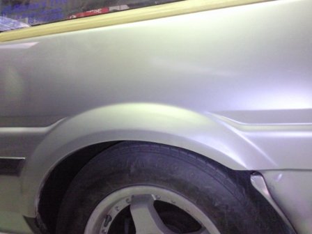

    More progress today after doing nothing yesterday Got the left rear quarter painted and it turned out real good. Primed the right rear quarter as well coz it had a lot of scratches and some small dings in it. Almost finished bogging the rear up so should have that done and primed tomorrow.
