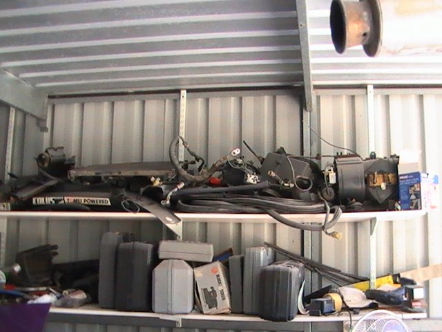

    The sound deadening was stripped by the previous owner. I'll be putting it back in as I want this car to be as comfortable as possible. I'll have air-con, power steering, power mirrors(from my coupe), central locking and a decent stereo.

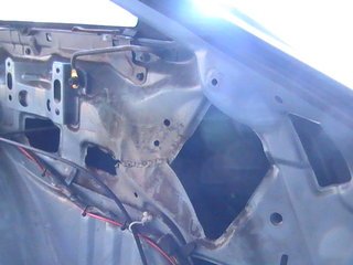

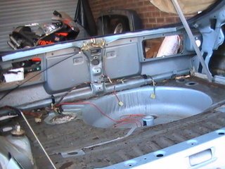

    I've stripped it down to a bare shell pretty much, and now the rust is popping up in the usual spots.
    I've treated it with rust converter, then I'll clean it with a grinder and weld it up.

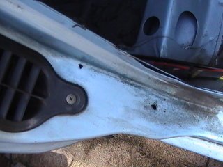

    ...and while trying to get at some rust along the windscreen seal I cracked the windscreen. So I removed it and found the rust to be pretty bad. Just as well as I cracked it.
    I've given it a clean with a wire brush on a drill and rust treatment.

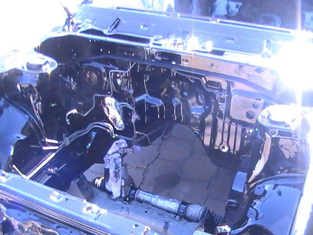

    Engine bay is stripped and degreased for a flick of black paint. That's next to do.

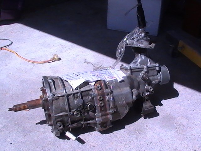

    One rebuilt w58 box bought off the forum, and and sc14 supercharger.
    Last weekend I got stuck into the engine bay to get it ready for paint. I painted it on Monesday. It was a quick job but looks good enough. I also primered the top windscreen seal to prevent it from rusting again.

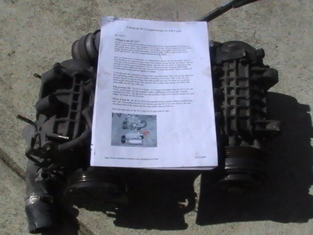

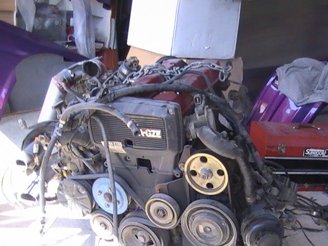

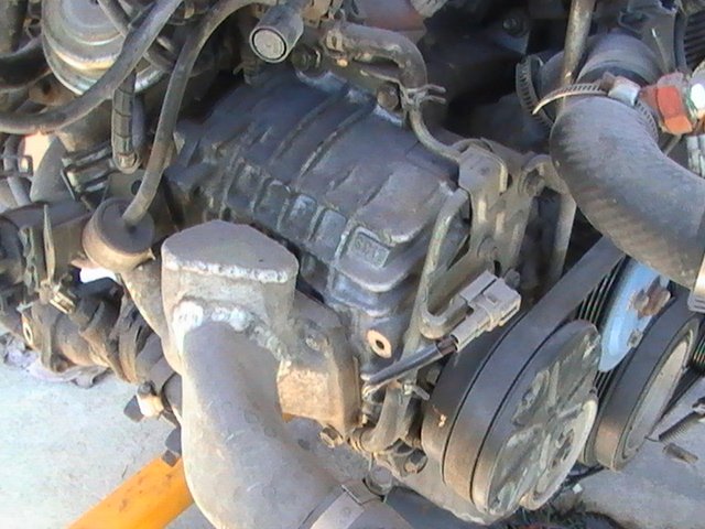

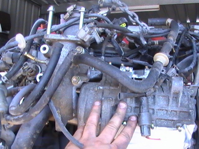

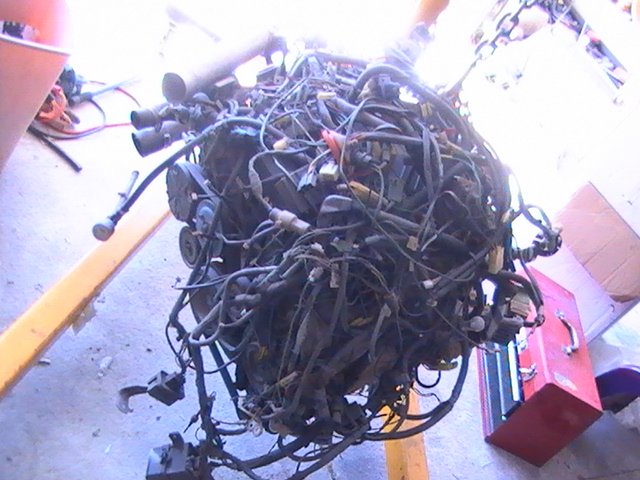

    Today I got the motor out to start on the sc14 conversion.
    I got the instructions off TOYMODS. Big thanks to 'ADSPORT' for the really simple to follow instructions.
    Here is the link for anyone who is interested. http://www.toymods.net//forums/showt...hlight=adsport

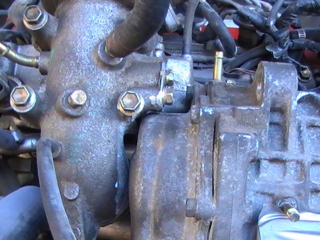

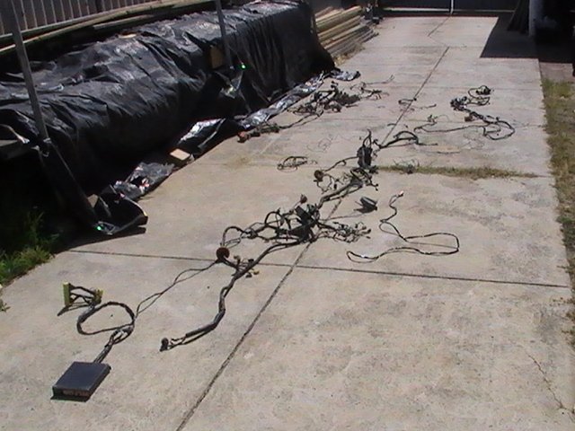

    I knew there was a motor under all that wiring. And first up was to remove the sc12 charger.
    Armed with my trusty instructions it was time to start grinding and cutting. Refer to the above link.
    ...and after a couple of test fits and grinding, the sc14 was in. Its a tight fit but pretty neat all things considered.
    Just have to finish the top bracket and get some groves machined into the front pulley and it's all done. Then I gotta figure out where all the hoses go

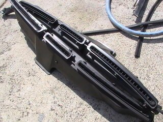

    Kind of sorted out the wiring... and soon the air-con unit, pulled out of my coupe will go in too.
