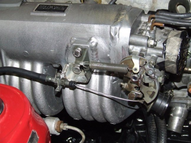

Don't forget to have a look at your throttle cable setup, we made another small aluminium plate to weld to the side of the plenum, and bolted the throttle cable/return spring bracket to that. If you go that way, you can get it all welded at the same time. The other way is to drill and tap the cable bracket directly to the plenum, but you risk drilling straight through the wall and having vacuum leaks.
