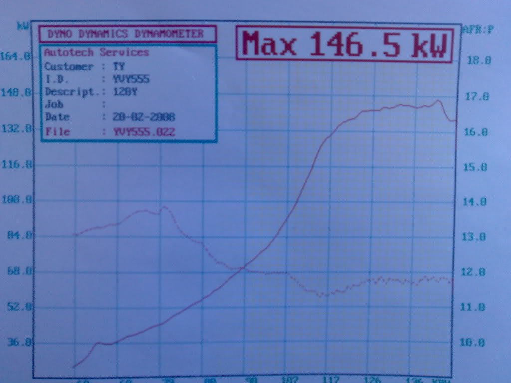

    My setup consists of a high-kilometre (apparantly it was taken out of a ae86 coz it was old and had low compression) bigport GZE (coilpack and MAP, not necessarily standard) with autronic, standard bigport RWD inlet manifold with TVIS removed, GZE injectors, custom steampipe lowmount turbo manifold and Hi-flowed FJ20 T3 turbo with BB core. 2.5" exhaust from turbo back. Oh and a very noisy T50 :2thumbs:
    It made 146.5kw on ~12psi. Thats 36kw more than the supercharger with the same boost, and 1.2sec quicker 1/4mile.

    636
    with the jdm amanifold back on my car made 166rwkw @18psi what izzzz going on

    130
    cams too big? blowing boost out of the chamber into exhaust?

    <div class='quotetop'>QUOTE (orangechargd86 @ Mar 8 2008, 07:12 PM) </div>compression or boost leak question mark

    lol 0.8mm head gasket, for them tuubos your should run a thicker head gasket even 2 gaskets, just to lower the compression
