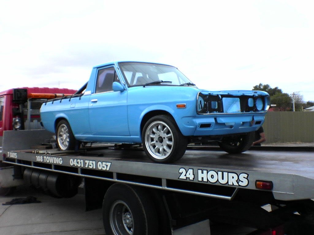

Colours....ummm never quite certain but atm im thinking like a light metallic navy, with 13x7 with 175/50's and 13x8 with 195/45's starsharks with gold centres
Coilovers are a custom lathe up job, pretty generic really, ive got eibach 250lb springs on them atm thinking of going stiffer, time will tell.
Rear wheels are a mates 15x8.5's +15 and sit super flush with the guards (untouched guards) but are fairly close too the inner guard so an 8 with the same front spacing is perfect.
And yes you are correct in saying there hard to find in good nick, but unfortuneatly its not just the utes anymore
GET A 1200 ASAP! haha
