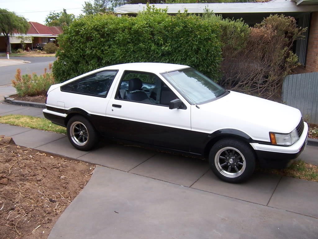

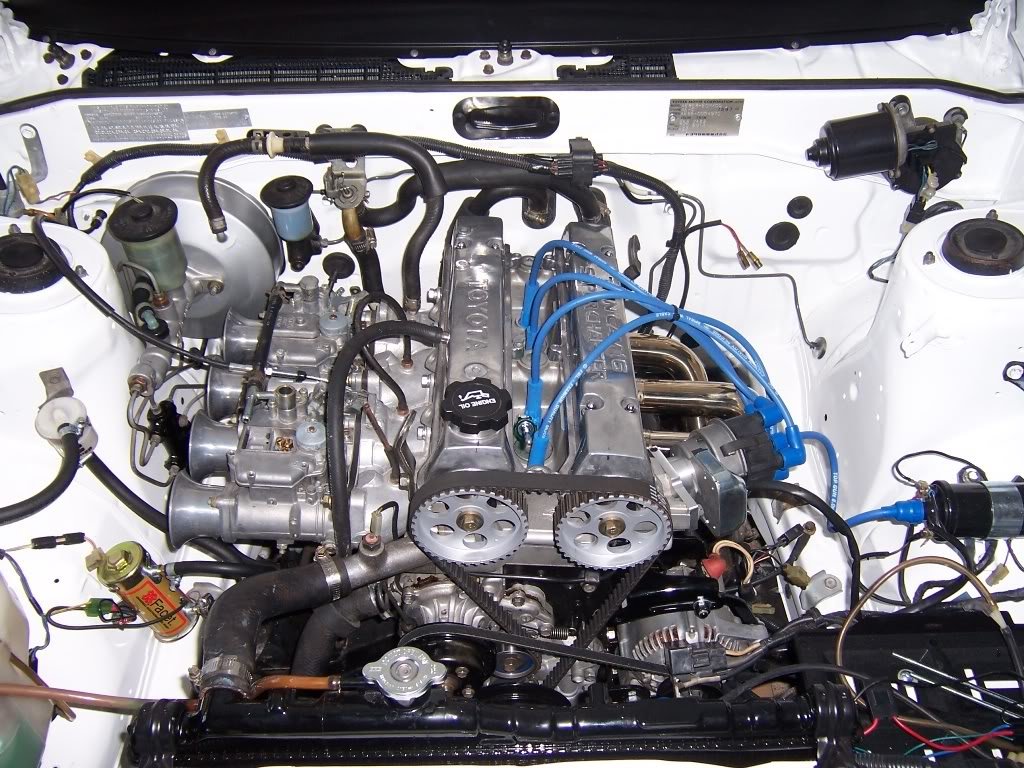

    Many of you would have seen the progress on my car already, so i wont bother posting heaps of photos from when i got it but these are the specs and how it looks atm
    Specs
    1984 Toyota Sprinter AE86
    Body: All rust repaired, brand new rear quarter panels, bitumen sprayed underbody, new windscreen trim and rear quarter window trim, 10 point alarm and immobiliser, Foglight Letterbox Grill, JDM headlights with eyelids
    Engine: 7 Rib Bigport 4AGE rebuilt using alkaline dipped stock internals, linished crank, ACL Race bearings, ACL Chrome-Molly rings, honed and decked block, TODA 1mm head gasket, Comp ratio 9.83:1, faced and cleaned head with 3 angle valve grind, MA70 Oil Cooler

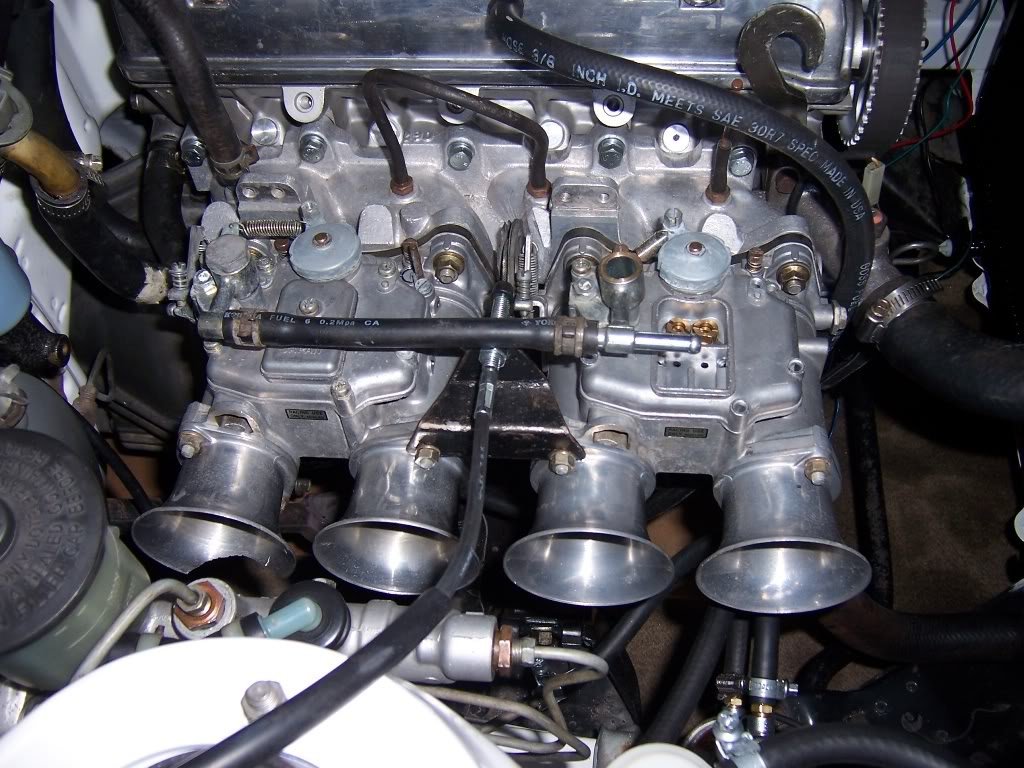

    Intake, Ignition, Fuel & Exhaust: Rebuilt PHH44 Mikuni carbs, Uni-Filter 4" sox, HKS Manifold, Facet electronic fuel pump, my grandpas aluminium injector plugs!, Scorcher Ignition (distributor and coil), 5Zigen Stainless Extractors, 2 1/4" Stainless system with metallic cat and polished Lukey Ultra Flow muffler
    Cooling: KOYORad Type-S 2 core radiator, RWD water set-up, Davies Craig 12"

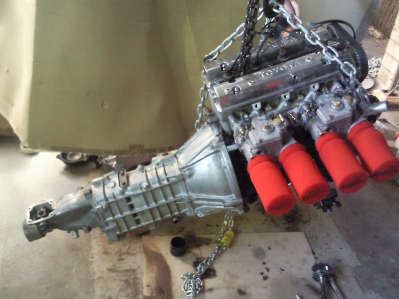

    Driveline: Fully rebuilt T-50 Transmission, Exedy Heavy Duty clutch, standard flywheel, S-Series diff (t-series sitting in the shed rebuilt)
    Wheels/Tyres: Konig Rewind 14x7 -9, Bridgestone Potenza RE001 185/60's

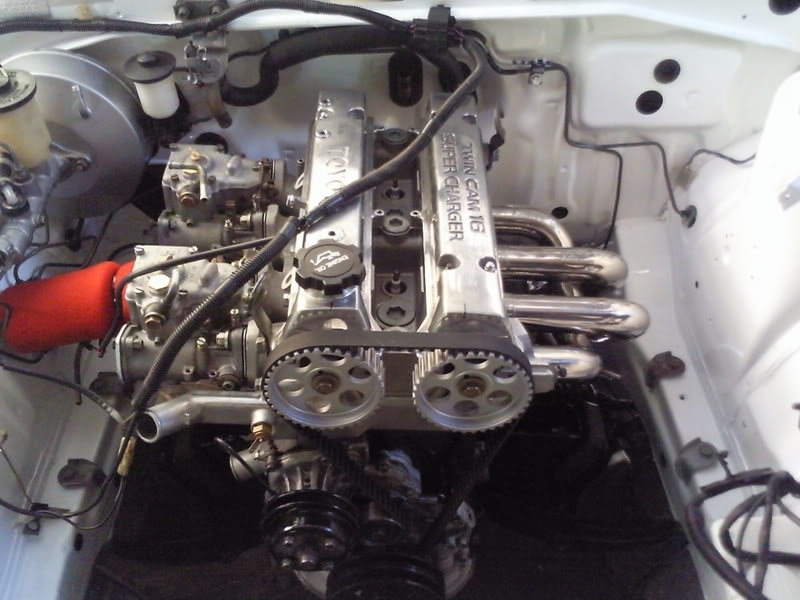

    Been working on the car a fair bit lately, putting her all back together, and today i finally got it started. It didn't sound to bad either straight out of the extractors, couldn't hear any strange noises so i was pleased. I stuffed around with the ignition for a little while and got a few grumbles and some flames out the carbies and finally she fired up. Here's a short video. Shouldn't be too long before she's on the road.

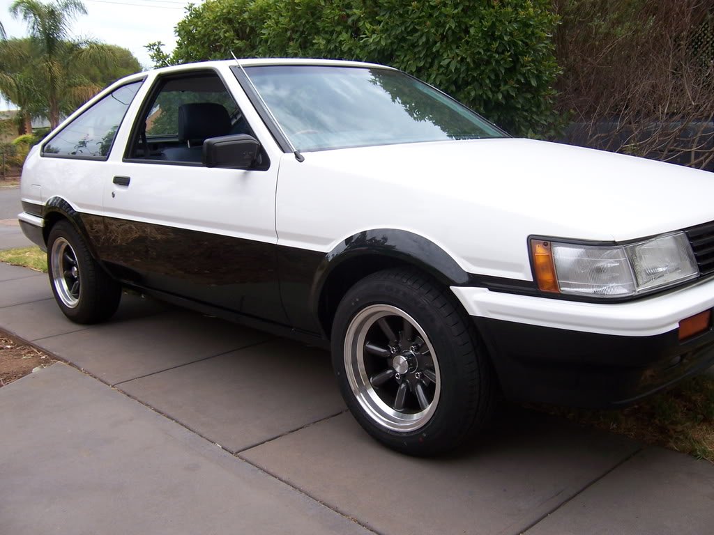

    An update on the car. I have now got PHH44 Mikuni carburetors on it now as the Weber carbs were garbage, and i runs really well just a touch which i can fix with some new jets. Went for my first drive of the car in over two years and everything works great and it has much more power than i thought. Here is a few pictures of what the car looks like now. I still have to put the white side strips on but i want to get them straight to ill have to take my time.

    LOVE the motor man. great work

    + 1. Engine bay porn.
