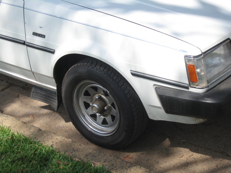

Well I received my ke70 on the 22nd of December, my birthday and present, and it has taken a turn from being complete to having nothing at all besides a diff and some wires.
It will be receiving a FULL rebuild, including new underbody spray. The build has been inspired by Teddy and Testsujin.
The build will be a aftermarket/restoration with some custom bits if i get bothered.
Here are pics of when it was on the Ebay listing:
Then it came home to me:
^^Yes I'm the doosh looking one in grey trackies..
A few days Later:
Took off the bumpers, Polished the wheels and removed the bump strips.

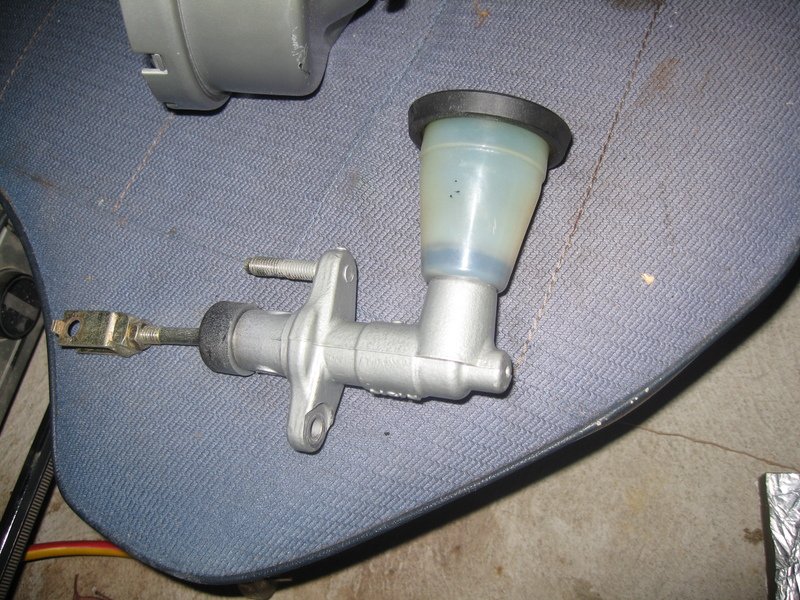

^^clutch master fluid filler was clogged with all this shit.. all cleaned now though

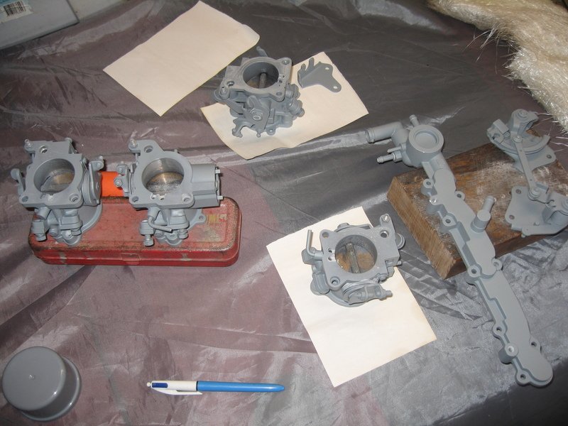

^^ITB plate all in primer, I originally wanted to cut it in half so i could reweld it back together upside down, so there would be nothing on top of the throttle bodies. Would have been too hard to do though.
^^All the Throttle Bodies and brackets etc all in primer, will be sprayed in black hea proof paint tomorrow hopefully.

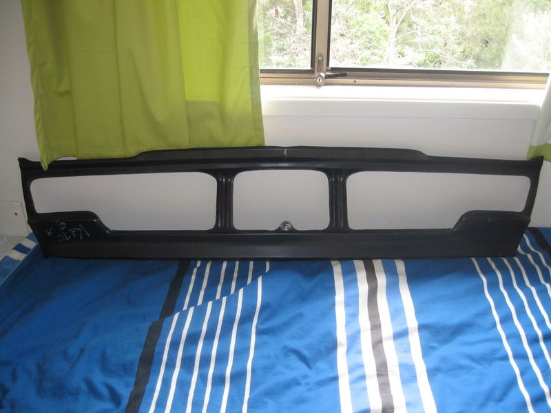

^^JDM beaver panel to suit the Quad headlights They are NOS (New Old Stock) items, so they arent bent or anything.

Pics of today, after i painted the Quad throttle bodies in the heat proof paint.
^^Rear view, still need to clean them up though..

^^Quad throttle bodies basically done. Just need T3 velocity stacks. Still looking into top feed injector options, I want a fuel rail bad. Would look fuckin dope in a polished aluminium or anodized silver.
^^Inside the throttle bodies have been sanded with 400 grit, Its heaps smooth. The acid clean made them all go furry inside, so thats all gone now. I quite like the end result
