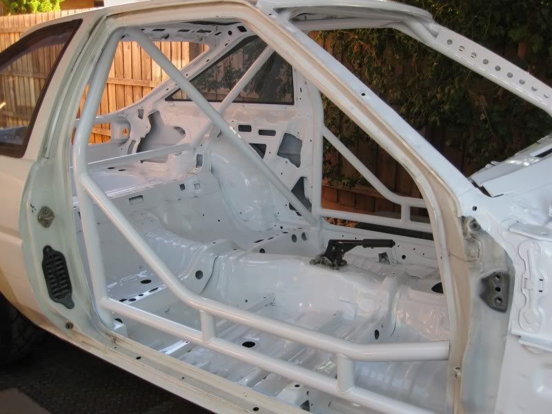

    Quote Originally Posted by slydar View Post
    wouldnt run jap doors unless i have a serious cage with a double x intrusion bar.
    ...like this:
    I'm looking to swap my ADM doors for JDM, they weigh a f*kn ton!

    Quote Originally Posted by Jase86 View Post
    ...like this:
    well yes. though thats not a double x, thats probably even better as far as side impact protection goes.
