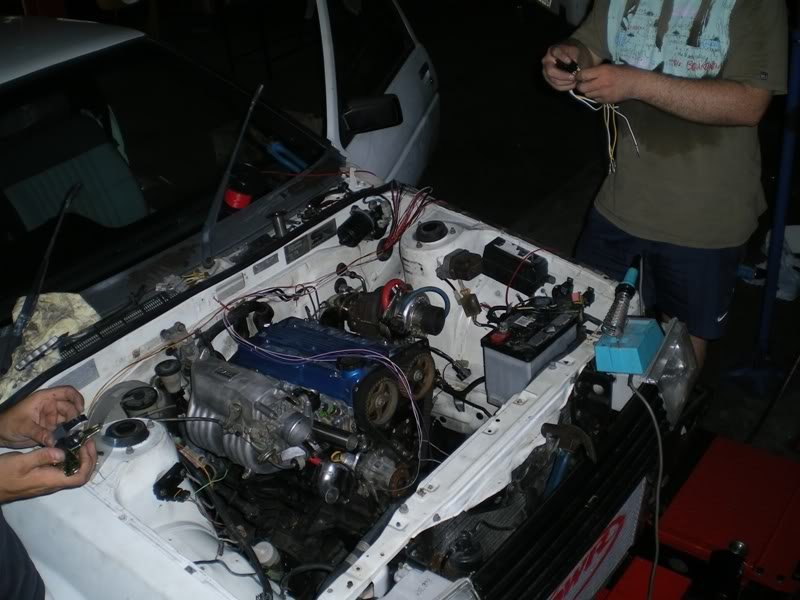

    Ok time for a quick update, I have have just gotten around to taking photos but the list of stuff done so far is:
    Turbo mounted on the KElway Manifold, we had to cut and shut the manifold to clear the dizzy
    Oil and water lines run for the turbo
    Modified the wastegate to suit the top mount turbo
    dump pipe made with O2 sensor bung so that I can run a wideband for data logging
    Heavy Duty Exedy clutch fitted with machined flywheel, the hub for the throw out bearing was missing so I had to order a new on from toyota
    Did up custom water pipes for the thing as it was a bare block
    Mounted the inlet manifold and polished up the fuel rail and fitted that up
    Dropped the engine back in
    Mounted up the intercooler, pipework should be done in the next couple of days
    Made up a 3" mandrel bent exhaust for it with a hooker muffler
    Started wiring up the Adaptronic on Saturday with the coils, map sensor, injectors and relays all done, just have to do the CAS and try and find a plug for the TPS and we should be in business. The car gets on a truck on Thursday to make it's way to Canberra so it is a bit of a race against the clock.
    Cheers
    Paul
