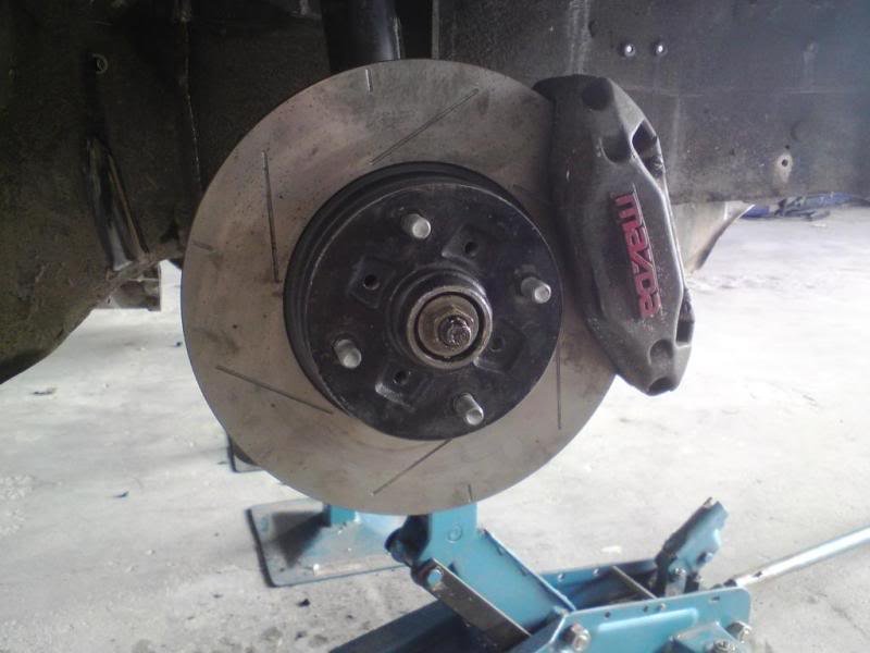

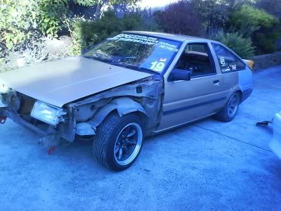

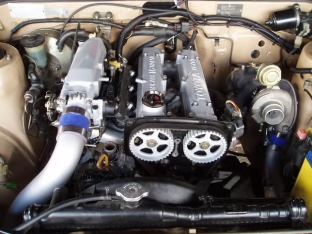

    Some people may remember my first build of this car a few years ago?
    My current build consists of the following:
    4AGTE
    AE92 smallport GZE
    quad throttles (silvertop)
    custom grind Kelford cam from NZ roughly 9.5mm lift 264 duration
    solid bucket conversion
    1mm over size valves
    HD valve springs
    match ported and smoothed casting marks
    ACL race bearings
    ACL steel ring set
    Cometic head gasket
    GT2871R turbo 0.64 rear housing
    W series gear box
    hilux diff
    front 8kg coil over sleeve kit, noltec camber tops (shocks not purchased)
    rear 6kg spring (shocks not purchased)

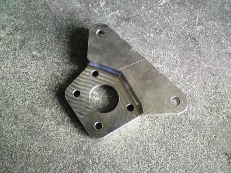

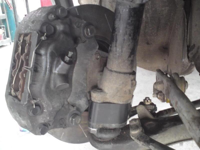

    294mm front rotors with RX7 FD calipers (custom bracket avalible to purchase)
    white line adjustable sway bars
    25mm bolt on spacer of front
    40mm RCA
    Corona LCA
    power steer knuckles
    6mm lock spacers
    Work Equip 03 15x9 -3

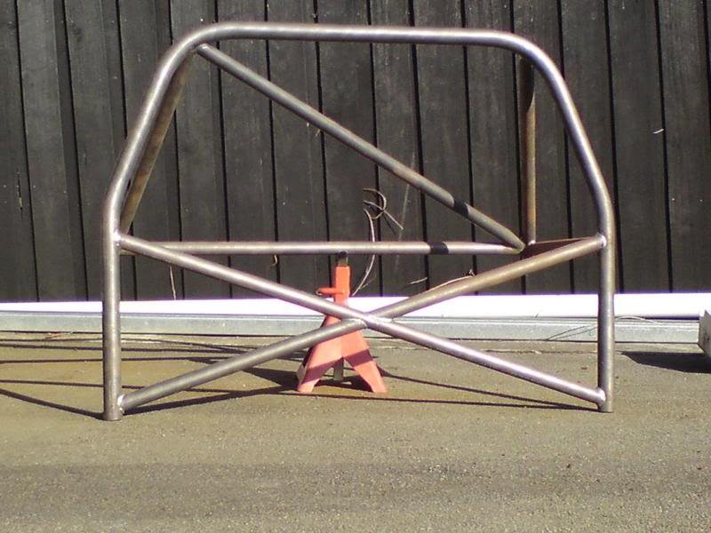

    CAMS approved roll cage
    fixed back seats
    trust nylon shift knob/ball
    D2 hydralic hand brake
    DMAX body kit
    TRD style? duck tail
    smoked crystal tail lights
    These are all the components I have collated so far fair bit more to do!
    Much Thanks and Praise to:
    john from Davidsons Autobody
    Matt from Tasmanian Engine reconditioning
    Aaron (and myself) from Azcustom Performance Fabrication
    Tobias from Koolstik Signs
    Here is a host of my current build photos of my ae86

    looks sweet man, got a power figure???? good luk with it all mate

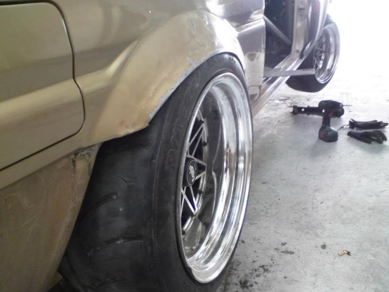

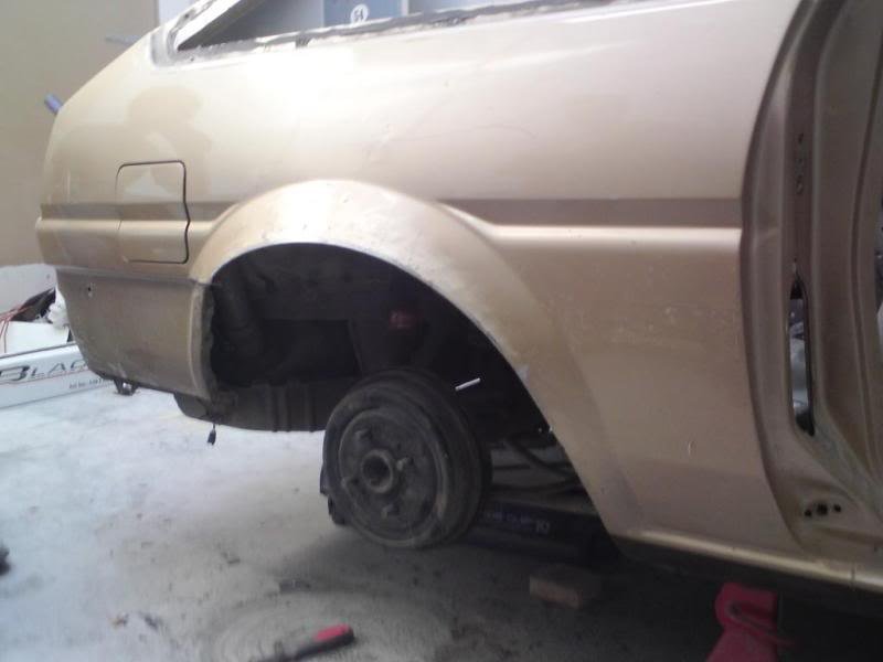

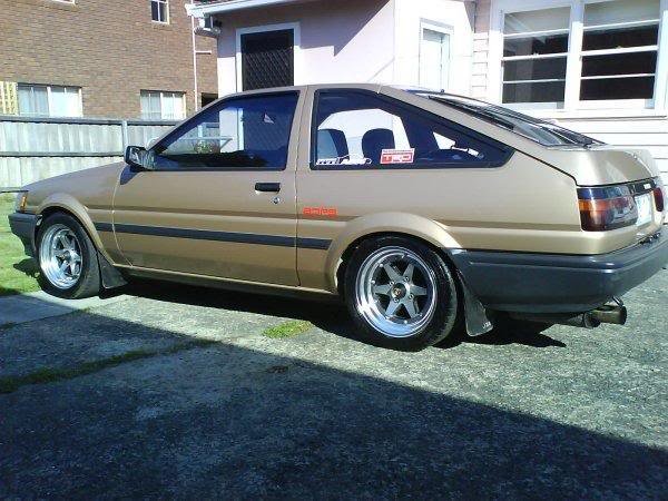

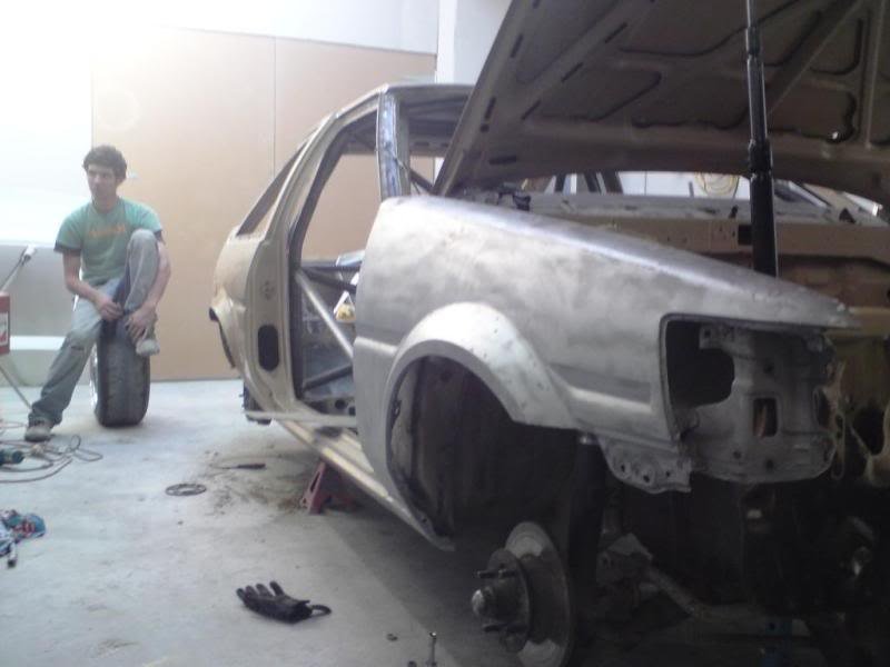

    I am a little worried about your tyre fitment and rear tyre clearance. I'm sure you have it all sorted.
  • #6
    Senior Member klusio's Avatar
    Kieran
    Hobart
    440

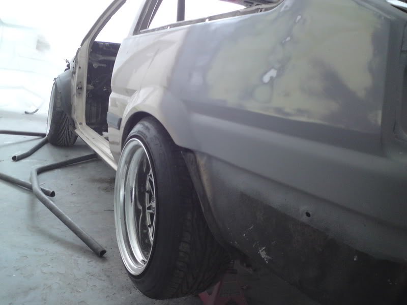

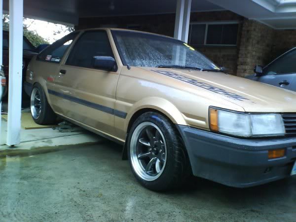

    No power figures yet but we are expecting just over 200kw at the wheels? the photos above are how it currently sits the engine should hopefully be together next week still a lot of work to be done.
    Jonny the photo is of the car on cut bump stops so travel is limited however we do plan to try get another 6mm or so out.

    finally getting something better then those ugly superlites again... good to see!

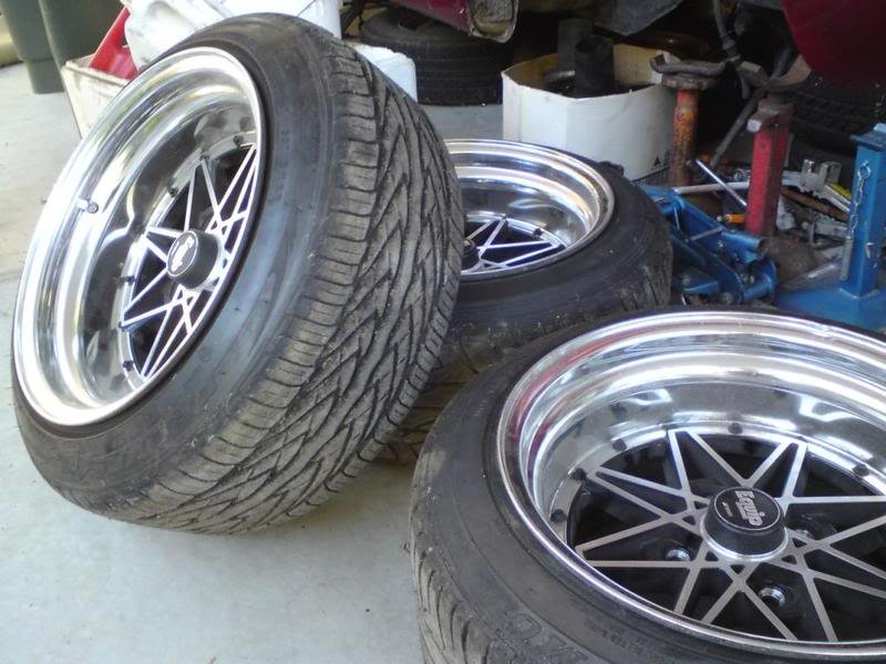

    Love the wheels......... !
