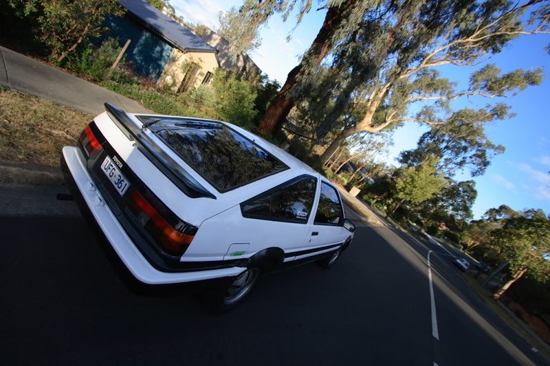

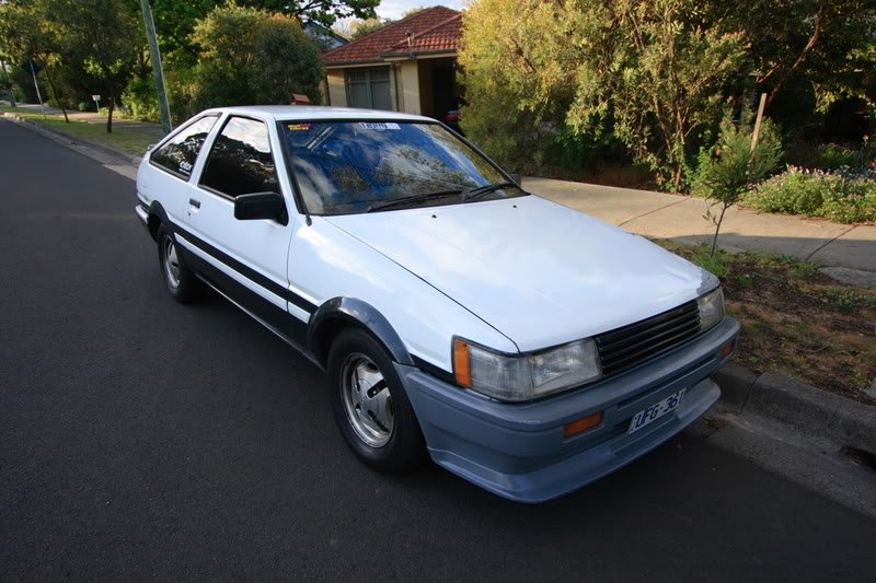

    On Saturday i picked up this 1985 ADM Sprinter with a 4ac as a run around. But the more i look at it.. the more i want to do! Haha.. so i'll see how it goes. Here it is as it sits now.
    P.s. ignore the bonnet damage an panels in primer. All will be fixed in good time.
    Here are a couple of pics for the moment. I'm looking for a set of wheels for it and to lower it.
