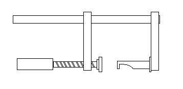

    I like the drill press idea.
    I made one from a big G-Clamp and about 3-4 inches of water pipe.
    Weld the water pipe to one of the G-Clamp jaws, and cut a slot into the side of the pipe to create an opening so you can get the collets and tools in onto the top of the valve stem.

    I was thinking of using the g-clamp technique after seeing a few of Sam_Q's post somewhere about valve stem seals. Should help hold down the springs pretty well while you place the valve keepers in their position.
    Does anyone have any ideas how we can put back the valve keepers while the motor is still attached to the block? Without buying that snap on tool that is.
