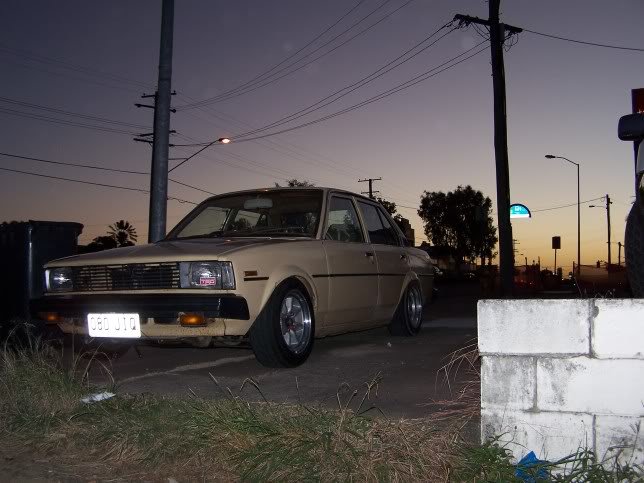

15x7.5 - 5 (ssr reverse mesh, must be the most common imported 15" ssr wheel ever)
sigma arm (1pc)
3.5 -ve
flaired guard.
rubbed quite alot but i dealt with it.
some shit house 195 50..
15x8.5 +20 w/25mm bolt on.
195 50
sorta stock lipped guards.
i say sorta cos they were rusted to fuck and repaired in an "interesting" way (cheers j panel shop)
but size will fit without a flair.
in all these posts, I'm sure all my wheels cept the froms on the 70, rub a tiny bit(unless otherwise noted), but nothing you should worry about if youre not a pussy.
should also be noted if you intend to run FRP front guards (or rear) or over fenders.. then you should run more clearance, especially on the front, or they can end up getting damaged (READ, blown to pieces) pretty easy.
