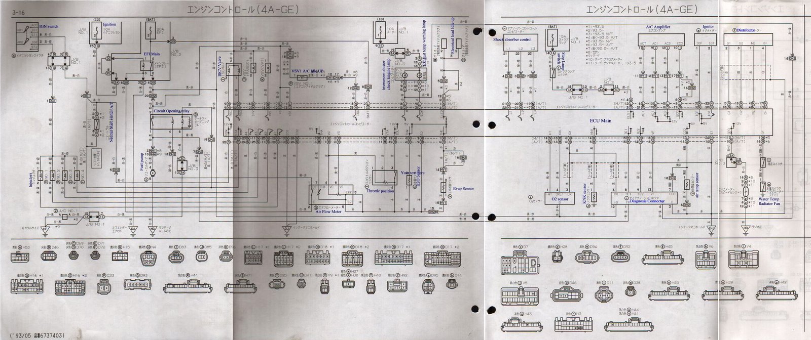

behold!
is there any about, step by steps, or has someone got an english wiring and pinout diagram.I'd like to go for a razorback ecu also but being in tas couldn't get it wired up by them, is there alot of difference when using there computer bar the obvious no afm and a map sensor instead

gee thats a really nice diagram,
you got one of those for a 16V bigport sam, by any chance?
also, on that diagram sais "shock absorber controller", any idea what that is? the MA70's have something like that i think...

pretty useless, but I know the document is around.
As for the shocker controller I have no idea

A whole bunch of JDM Toyotas have a shock control thing, including a HiAce van I drove the other day. Some cars will just have a light on the dash, and the ECU will change the shocks from soft to hard at a certain speed. Other cars have a option button to choose soft/medium/hard or auto.
I think Josh is after a blacktop ecu and wiring diagram.
let me see what I can find
