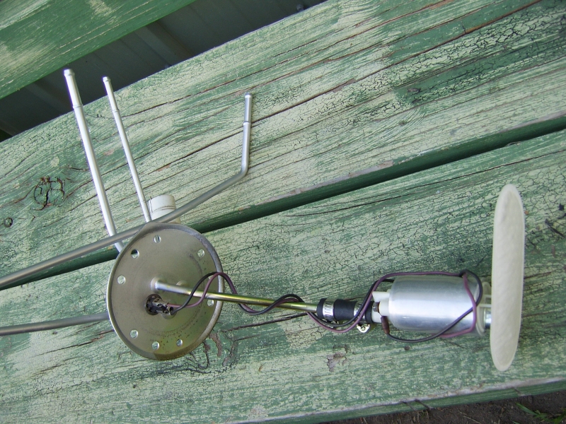

    right progress report!
    yesterday was a very productive day, i installed an internal lift pump! it is quite possibly the best thing i have done to my car!!!
    i followed this:
    very excellent tech article. i recommend it.
    here is a pic of the pump, i pulled it out of the box and thought it was far to small, but apparently this can supply enough fuel for 300hp+ so its good enough for me.
    and no that is not a real DB9.
    right now i picked up another fuel thing from the wreckers, so i could just swap it over after building it.
    i ended up taking the tank thing to the local hydraulics shop, and got them to silver solder soem 5/16 barb fittings to all the pipes. i HIGHLY recommend this, no more leaks. the standard pipes are just to small for 5/16 hose (standard size for fuel pumps). though these barbs made it almost too tight! needed a bit of oil to actually get the pipes on.....
    i also got them to flair the pipe where the pump was connected to. also recommended.
    anyway here is a dodgy pic of the barb fittings.
    right now, i had to drill a hole for the electrical connection, and of course i broke the little clip that holds it in on the VL, so what better thing to do, than fill it up with araldite!!!
    and here is my dumming up of the pump, fits real good, the pipe is a tad small for the rubber hose you get with the pump, but the flaring takes care of this.
    unfortuntely i was to excited to take a pic of the completed product before i put it into the tank. but it looked something like this (stolen from that tech article)
    and here it is all installed.
    the verdict?
    ITS INCREDIBLE.
    i am using this pump to feed my surge tank, and then a bosch070 feeds the engine. i cannot hear ANY noise at all from both the pumps. i used to be able to hear the noise after a longish drive, but there is absolutely no noise at all. i took it for a drive for about 45mins today, and the pumps were silent the whole time.
    so all in all yesterday was an incredibly productive day!

    nice, i did exactly the same thing with my old 4age and standard ke70 tank setup,
    i used a bosch r31 skyline in tank pump to feed my surge tank, overkill but it worked.
    Soon as you take load off your main pump it quietens down heaps,
    after i put an 044 in it was still noisy though but made me feel happy in the pants.
    its just another one of those reliability things that work well, in that above pic there is way too much wiring in there, you want pretty much a dead straight line of wire, not too much of a biggy but petrol makes the wiring harden, and when your fuel slops around it makes it flex and creates minute cracks all through the insultation after 3 months even.
    Another one of those piece of mind things, if yours is uber long i wouldnt even worry about it.

    and yer on my setup i cut the wires very short, so they were only just long enough to reach (prolly 120mm of wire or so). im not sure why the guy in the tech article didnt cut his short. i think maybe because he used the standard clips on the connector thing, where on mine i cut them short and soldered them on.
    ive also recenetly put a fuel pressure guage in my engine bay (trying to diagnose that problem i had when the engine would break down after 20mins). and with the old setup the fuel pressure would vary 1-2psi continually, but with this new pump in there the pressure is rock solid which im fairly happy about.
