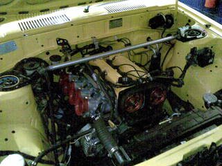

    small port, ae111 quads, fidanza sprockets, I.mec rams
