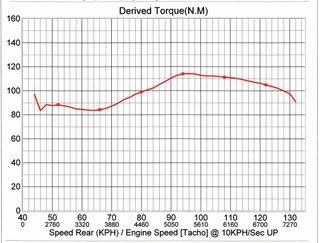

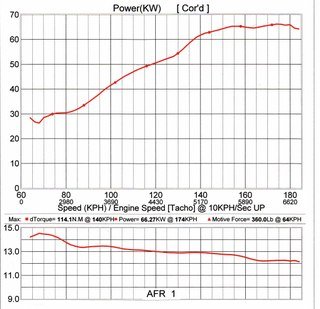

    Hi guys, finally scanned the pics.
    I have taken off the top of the dyno sheets as I don't want the owners details etc to be posted up.
    BUT let me assure you, these are all legit, done by the same operator(me ) and using the same correction factor etc etc etc The dyno used is a Mainline.
    I really don't want to hear comments about dyno accuracy, if these are all done on the same dyno by the same operator then we can all say the testing etc was the same
    There has been a reason I typed all the other stuff previously about the operation of the dyno, so that when less experienced forum members saw the figures, it would make sense to them.
    This is also the reason I have printed out DERIVED torque curves, so it sort of makes more sense to guys not use to seeing dyno runs, that and I don't have to put up with fuckwits making comments that a 16v bigport had 250NM of torque.
    Please note that ALL the runs have been mapped over RPM(bottom axis) so ignore the road speed and just look at the rpm.
    Also sorry for random hair on some scans(was on my scanner) no smart comments it's obvious it's from my head
    This is a bigport with what I call typical low cost mods;
    Pod filter
    4-1's and larger exhaust(2 1/4)
    This is very typical of a near std 16v bigport, on our dyno they usually get between 60-66kw depending on engine condition, typical a/f ratio, this one gets a little rich above 5900rpm, torque curve is fairly flat, this would be nice to drive on the road.

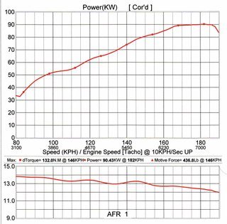

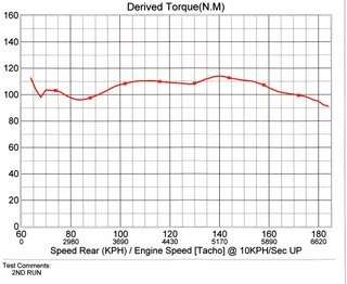

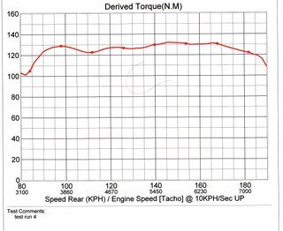

    The second set of runs were a car which was powered by a bigport, 264deg inlet and exhaust cams, 4-1's, JDM cat back, lightweight flywheel
    a/f ratio on this is quite good, a little lean between 4800-5800rpm, with a corresponding dip in torque at that point, richening it up could smooth that a little, this produced good power considering mods, torque is quite soft below4400rpm, maybe some fettling of the cams could of helped, typical of 16v's it's all over before the rev limiter.
    This set of runs is a ST running stock ecu/afm, pod filter, genie headers but 2 1/4 exhaust
    The a/f ratio on this 20v ST was a little on the rich side, power output was as expected and the torque curve is very nice, this has quite a wide torque band and if you compare to the 16v's much nicer, typical of ST's it shuts down well before the rev limiter.

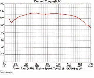

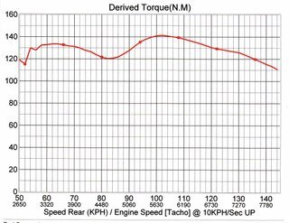

    This set are from a standard low km BT, which had the ignition timing optimised, royal purple oil, redline transaxle oil etc.
    As you can see the BT definately delivers the goods, the a/f ratio is quite good BUT the torque curve is not the nicest, even tho the torque is much more than the 16v's it has a substantial dip at 4800rpm, what is funny is that even with this dip the torque is still more than some modded 16v peak torque figures, anyway, the down side to this dip is this car feels wanting below 5000rpm, this is the magically rpm figure you are all ways waiting for/looking for! What is nice about the BT is the way it keeps producing good power to rev limiter, above 5000rpm the BT is a great engine, standard THE best 4age.

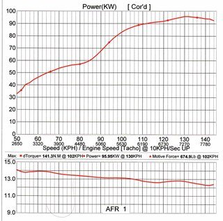

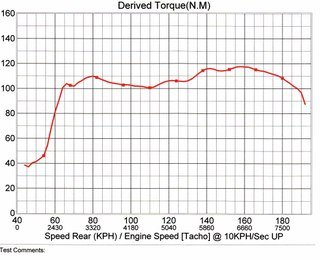

    This set of runs are from a 16v small port, 100kw MAP ecu, AE111 quads and velocity stacks, 4-2-1 headers, 2 inch exhaust, 264 HKS inlet/exhaust cams and optimised cam timing via vernier sprockets, TRD thin head gasket, light weight flywheel
    This engine put out the goods, I was not expecting this output with these mods, it did take about 2 hours of messing with cam timing to get an engine which was razor sharp(everywhere, off idle, low rpm, mid and high rpm) and revved cleanly, a/f ratio on stock ecu is suprisingly good, I even checked throughout the rpm range at different engine loads and it was good. What a fantastic torque curve, this is the sort of torque curve you boys that do hills runs want, no nasty suprises, just nice torque everywhere, you can see that even with cams etc etc typical of 16v it shuts down before rpm limit(obviously bigger cams/head work would alleviate this) But overall this is the sort of 16v engine that would do as a nice daily and still have some fun in the hills and do a few sprints at the track.

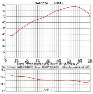

    Just for comparison I thought I'd throw in what everyone on the internet reckons is the best NA 1.6ltr engine made, the Honda B16 vtec, this one was fitted with pod filter and cat back JDM exhaust.
    This suprised me in that I was expecting alot more from this so called legendary engine, don't get me wrong, it sounded balistic and 86kw is nothing to sneeze at, but I just thought it would deliver more, when you overlay the BT torque curve the BT kills it EVERYWHERE. But having said that, it's still an excellent output from what is basically a standard 1.6 ltr NA engine.

    Frak your my new hero. Amazing torque curve on the blacktop, was that with VVT? Do you have a curve of a 20V with an aftermarket ecu that has a nice tune?
    I was quite suprised by how linear the power curve was on the B16, I would of thought it would be been much more peaky considering the nature of the VTEC system.

    The BT is completely standard except for altering the ignition timing, good oil, new filters etc, that's with the VVT, which suprised me as a ST doesn't act that way(very minor dip), that BT(belongs to me, it's my daily driver) is now fitted with I.Mec short rams and picked up 6kw at the wheels BUT it makes the dip feel like a chasm! BUT above 5000rpm it really get's going as would expect of an NA with just over 100kw at the wheels!
    But for sure Sam, I think it shows just how strong a BT is.

    I was actually a little disappointed with the Honda, don't get me wrong, it's a wicked output for an NA 1.6 BUT I just thought it would deliver more, I really expected into the mid 90kw's.
    Just on Sam's comment, a linear power curve is a dead give away that the engine has a flat torque curve, compare a power/torque curve of an engine with a flat torque curve and one with dips etc(BT) and check the shape of the power curve.
    Now some people like an engine that feels peaky, ie, the torque curve is not flat, they feel this adds to the excitement.
    An engine with a flat torque curve can feel boring, but when you look at the speedo or look at where you just came from you will be suprised, an engine with a flat torque curve will be easier to drive on the limit, no nasty suprises from dramatically increasing/decreasing torque!
    Nowadays manufacturers try very hard to make an engine that delivers a very flat torque curve.

    Just wondering, I'll basically have this setup you posted "This set of runs are from a 16v small port, 100kw MAP ecu, AE111 quads and velocity stacks, 4-2-1 headers, 2 inch exhaust, 264 HKS inlet/exhaust cams and optimised cam timing via vernier sprockets, TRD thin head gasket, light weight flywheel"
    I will be running the same (HKS 264 8.1 cams, Quads, 4-2-1 headers, adj cam gears, etc) as above with addition of an Aftermarket ECU (Microtech LT10s), GZE injectors and 2.25" exhaust, also I have smallport bottom end and bigport top. I will not have a lightened flywheel yet though.
    Reckon I'll see much more increase over the results you posted?
    I'd love to get an extra 10rwkw from the difference I will be running to hit 100rwkw, would like to hear some thoughts based on Fraks results / other previous experience.
