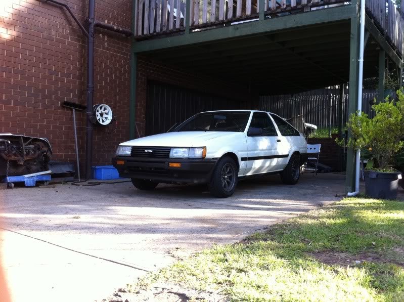

    brought it home like this, it needed some work but that was expected from a 26yr car

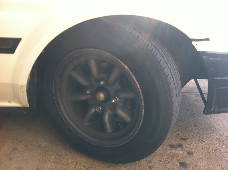

    Stripped down and cleaned everything that could be cleaned, replaced everything that needed replacement. The stocks tyres were shredded so i found some Watanabes, chucked them on straight away. Bought Kouki Parkers coz my ones were cracked and mouldy

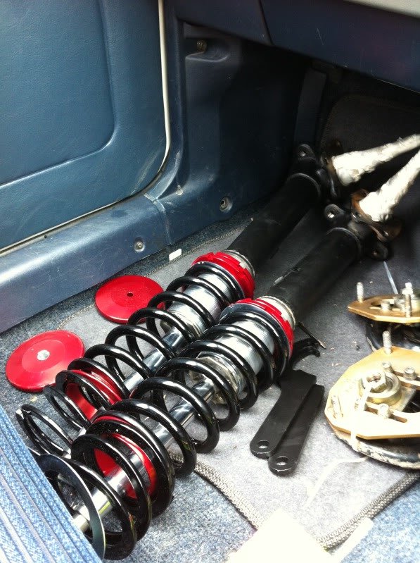

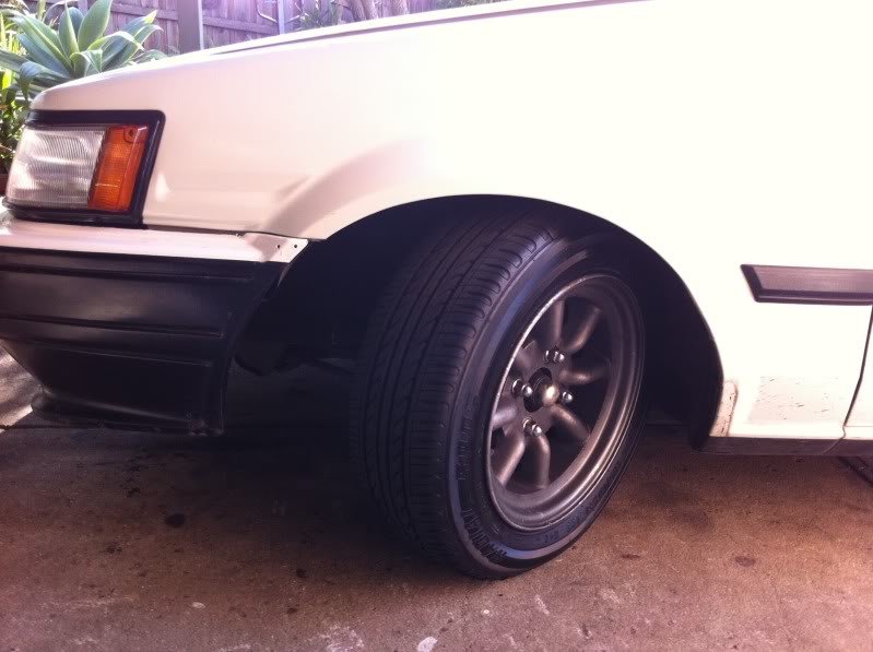

    The bodyroll was insane, plus the car looked shit being so high. So i got HSD Coilover sleeves and made these,
    Ended up like this! Feels so good

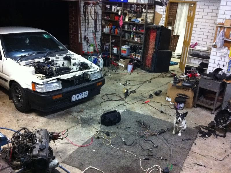

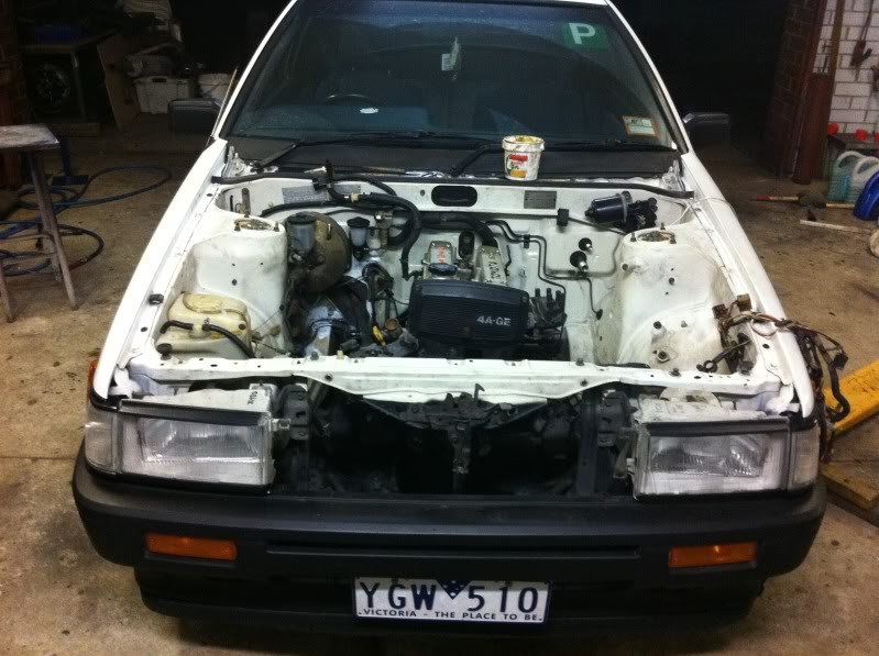

    Got sick of the 4ac power, so i bought an AE93 just for the smallport
    My workspace quickly turned into this mess

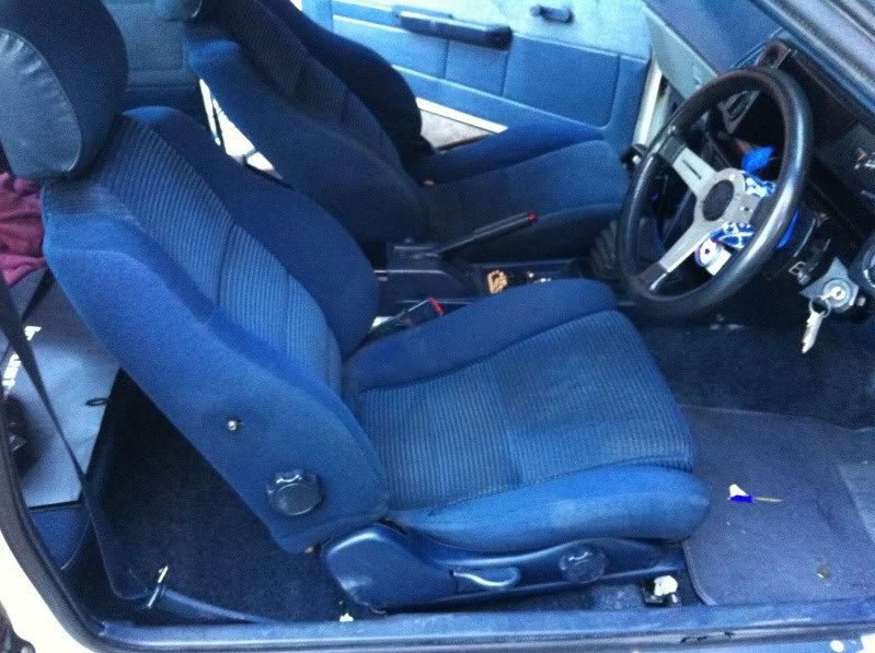

    moarr pics of mr2 seats please

    I'll chuck up some pictures of the seats soon, three of the 4 bolt holes from the mr2 rails lined up perfectly, i just drilled out the hole that didnt line up and it went straight in. Has a slllliggght lean in but its not even noticable. Really comfortable, standard looking seat, hugs very well aswell

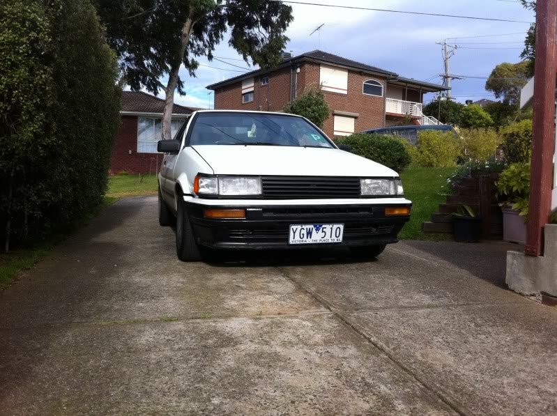

    Enough talk, heres some pics i got a couple days back,
    Oh and Jippy, heres a pic of the seats, they look so filthy in this picture. Got them for free so i dont care anyway they came with no headrests so i chucked the standard sprinter headrests on there haha
