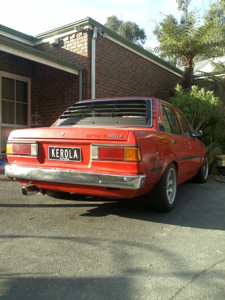

Got a KE70 for the rainy days a couple of years ago.
It's auto, 4K and stock (except chopped springs) but has rego
I planned a 4AGTE for it and started collecting parts to build it into a track car but ended up getting an R31 dedicated to the track.
Now I'm leaning more to a 4AGZE if not just a worked 4AGE.
But for now i picked up a manual KE70 donor car from a mate because my auto completely shat itself
